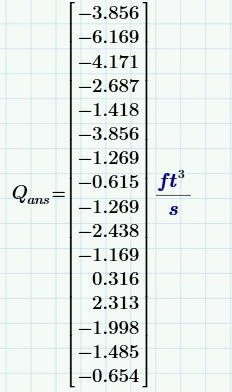

The first and second equations for change of pressure in the solve block have all positive pressure values summing to zero.  This is impossible arithmetically so some of the flows must have negative pressure?  This means negative flows in opposite direction from that assumed.
The equation for change of pressure has Q squared which always returns a positive pressure.  I have included the sign function so it is possible to get negative pressure from a negative flow regime.   Hence the first and second pressure change equations in the solve block can have sums that sum to zero.
Enclosed is file with solution.

Unfortunately, I can't open it because our school uses MathCAD 4.0 Prime. It won't let me open it. Could you provide more screenshots of possible?

Anyway, here's Terry's file in Prime 4.
