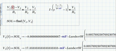

You could use symbolic evaluation
But you can't evaluate the functions numerically because LambertW is a symbolic only function.
So you would have to resort to the numerics

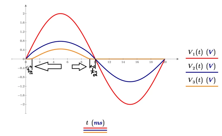

Cornel19-TanzaniteAuthor
May 27, 2024 1:20 PM UTC

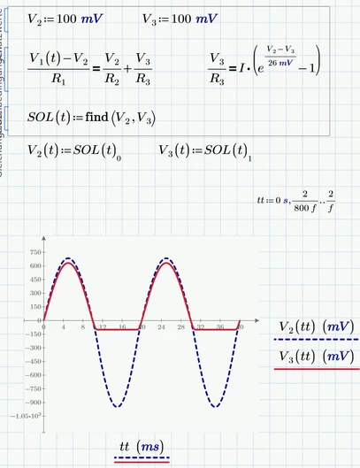

This is:
Now, how to find this?
And this:
May 27, 2024 1:31 PM UTC

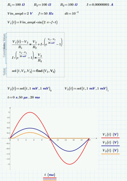

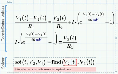

Do you have any idea why V2 and V3 should not depend also on t, like V1(t)? Initially I was expected/thought that also V2 and V3 should depend on t in the solve block like V1(t): V2(t), V3(t), but it seems that V2 and V3 in solve block should not put to depend on variable t like V1(t).
This not work:
I see that as you have posted firstly above works: this work
