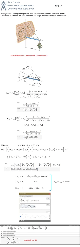

Good morning friends of the forum, I am new to mathcad,
I would like to ask a question with the masters of the forum, how can I build the problem that I send in jpg in mathcad prime,
I will post the solution of the problem that was made in microsoft mathematics.
I wonder if it is possible to solve the same problem in mathcad prime.
MT 5-17.pngAttached also what I can calculate in mathcad, is incomplete.
23-Emerald I
Attached Prime 4 file should be readable with 4 or 5

Fred did not have the words to thank for help in my problem, I learn a lot from you every day. TKS
