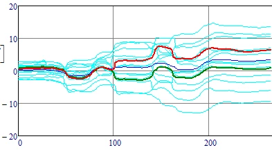

Comparing the two curves with index 9 (red) and 10 (green): How would an "equalization program" decide that the red increasing at 100 is wrong and should be decreasing like the green curve?

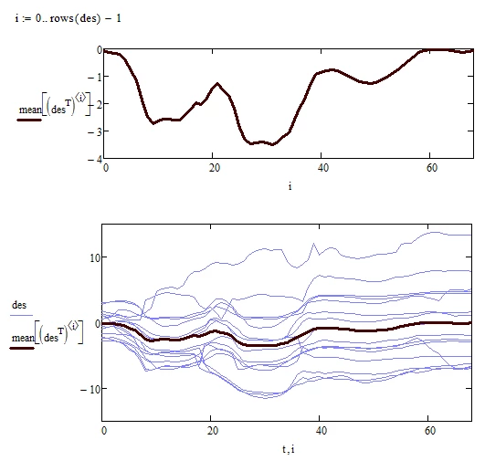

Synchronizing seems excessive to me, but it is possible to average:

If averaging as shown by FM is what you are after, it can be done that way, too:

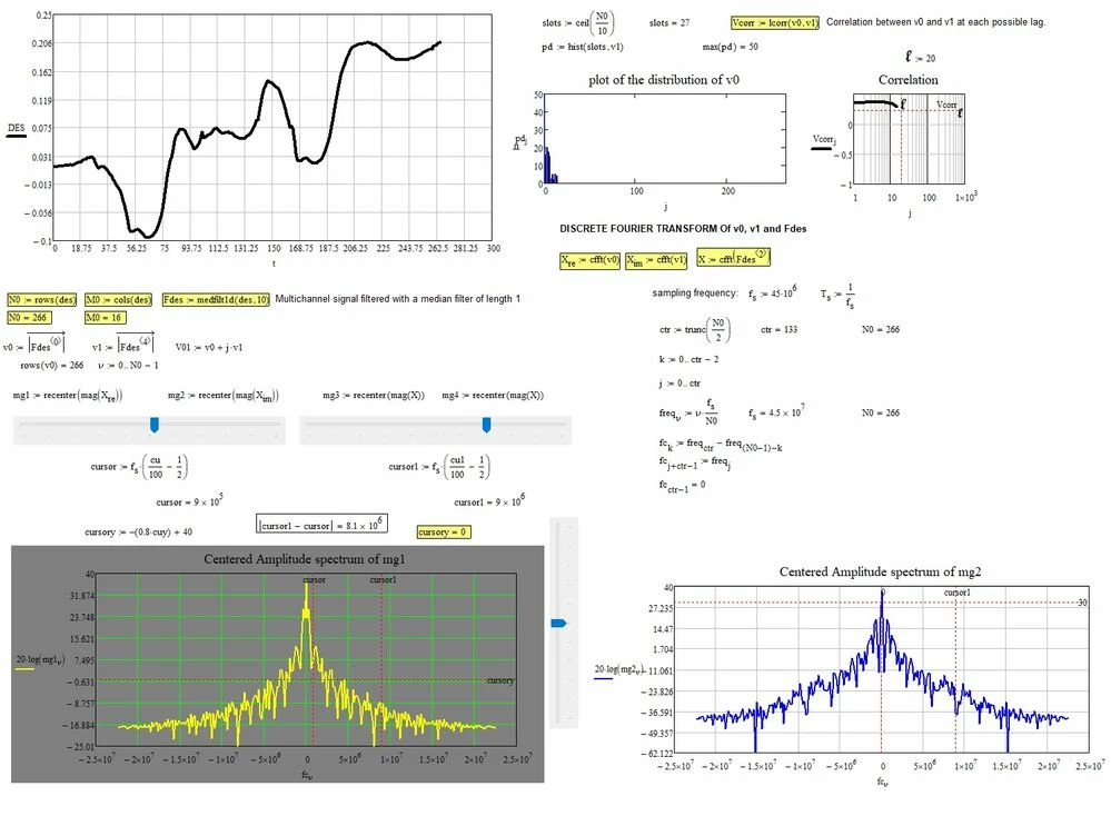

i have uploaded new files check once.
23-Emerald V

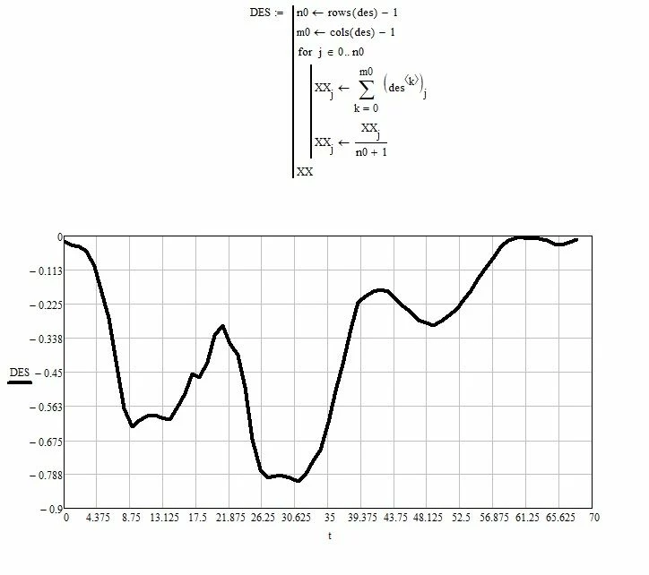

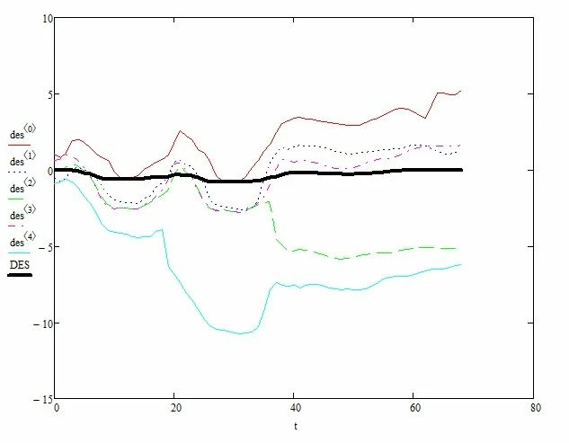

See if this helps.

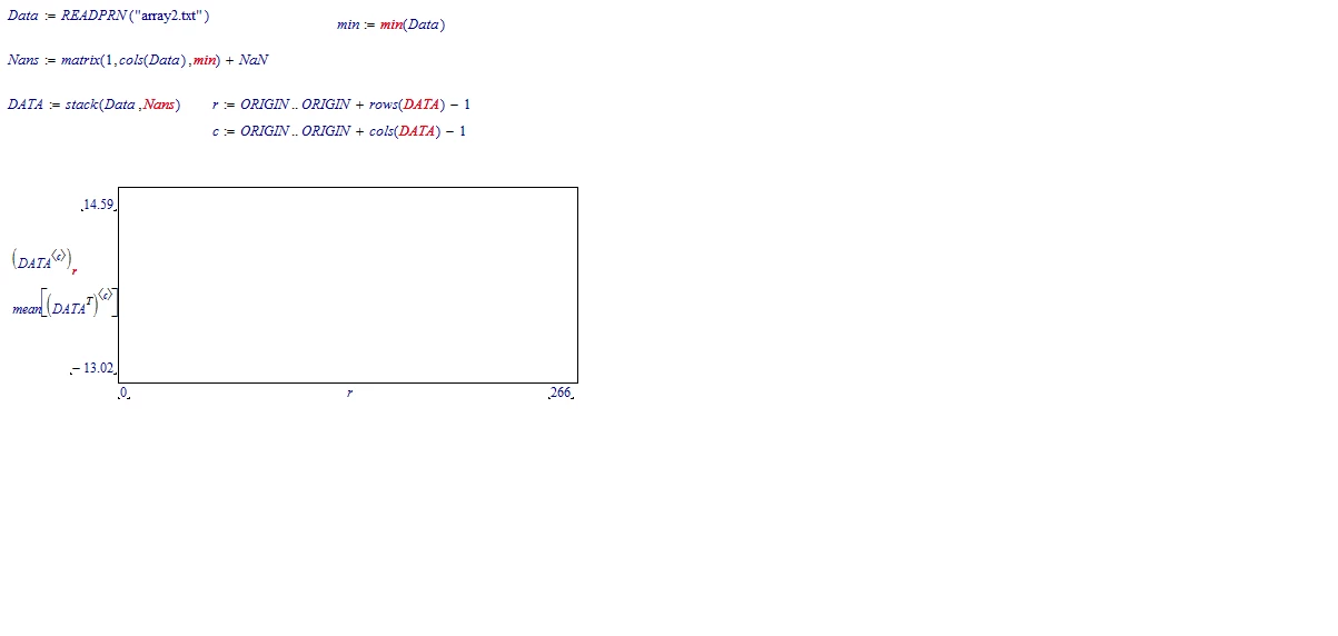

thank you for reply, but have problem with "min" function
