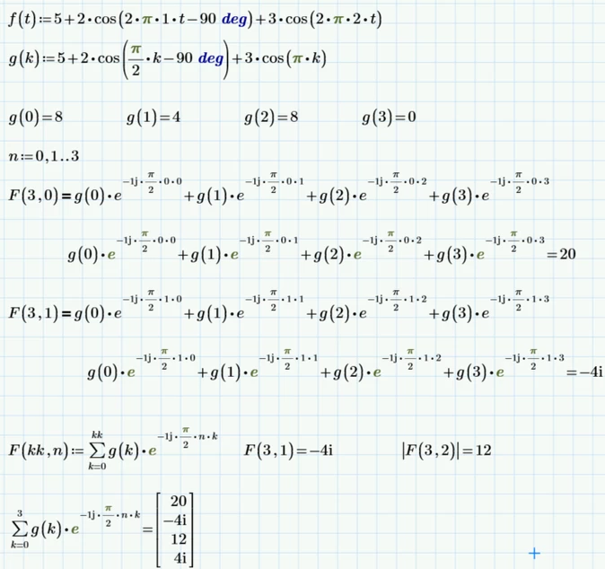

Suppose that we will sample this signal at 4 time per second (fs=4Hz) from t=0 to t=3/4.

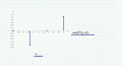

I have tried something manually, but how to show phase plot I do not know right now...

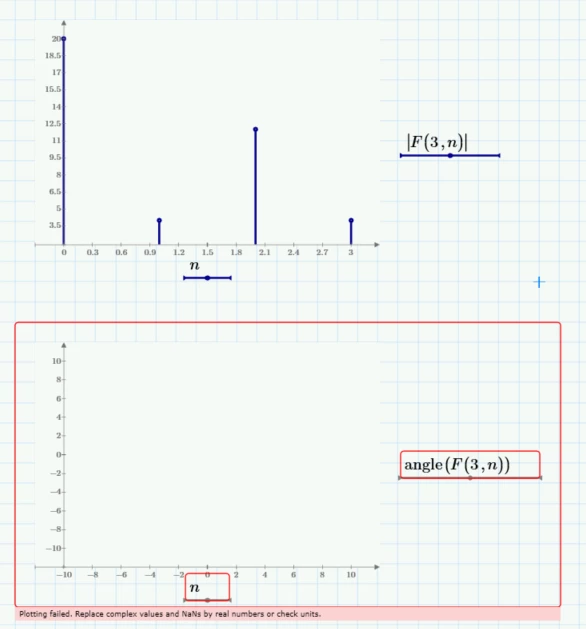

You have to use "arg", not "angle"
You may want to lookup these functions in the help

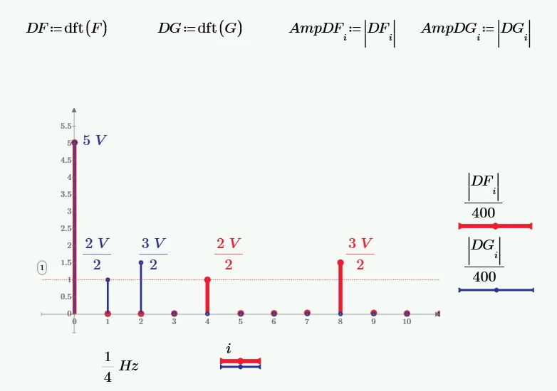

Magnitude of spectrum must divide by 400, the number of data used to dft.
A half of its value is the n-th value of the spectrum. Another of harf is at the bottom of spectrum data, such as DC, 1st, 2nd, ..... 2nd, 1st.

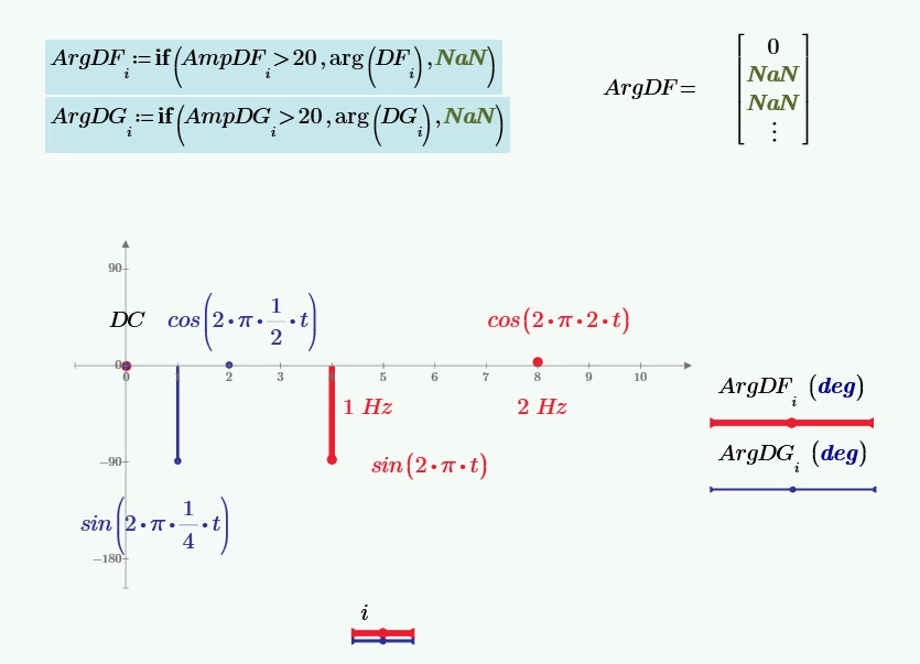

Phase of signal seems to valid for spectrum with magnitude more than 10 or 20 in this case.
