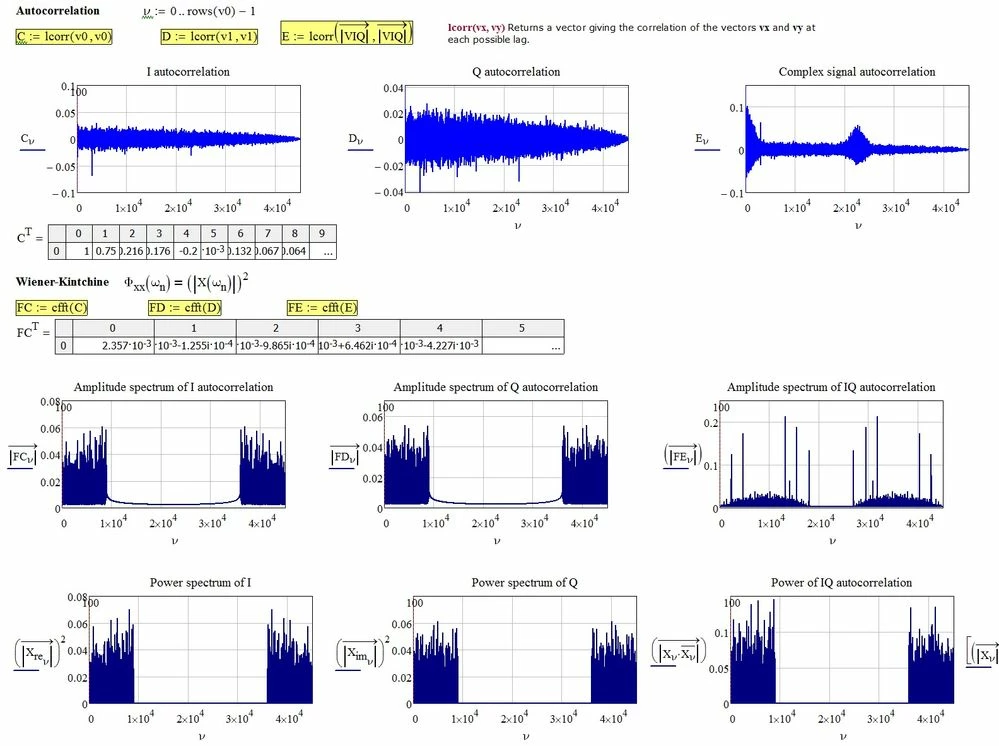

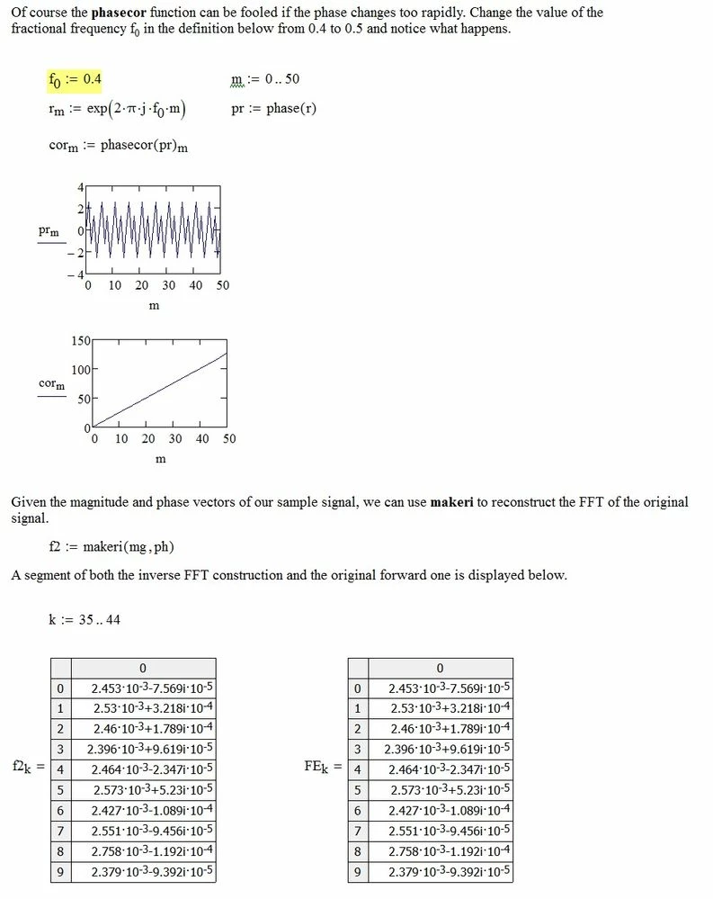

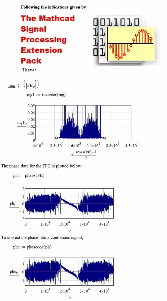

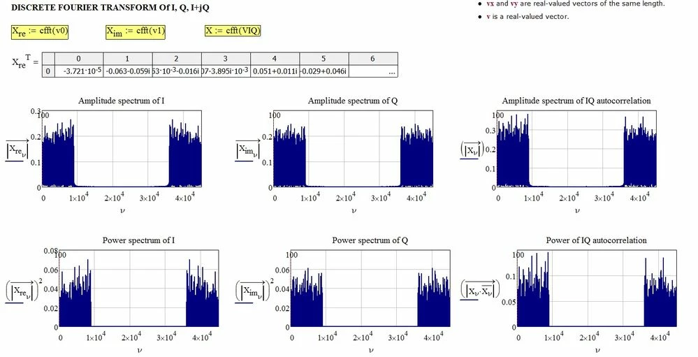

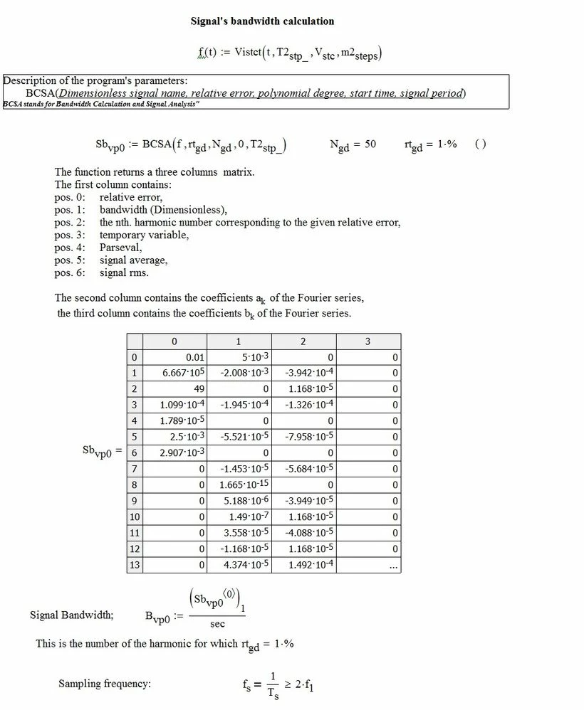

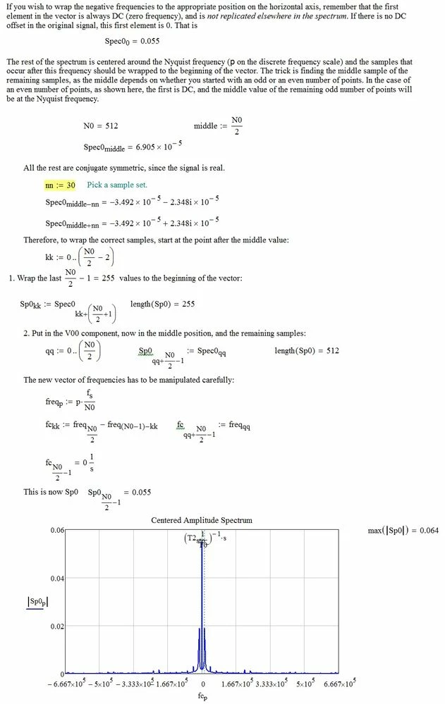

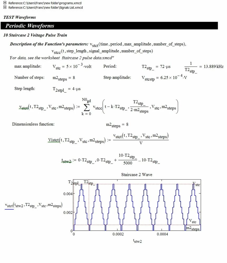

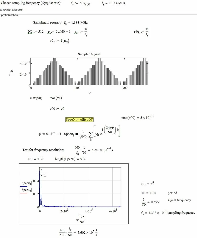

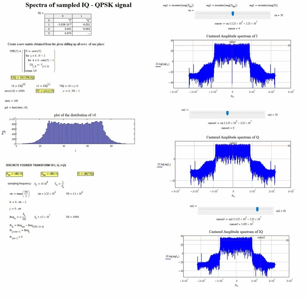

See if this example can help
February 22, 2018
Regardless of the signal, in general to calculate its spectrum you should follow the procedure of the example here below, do you agree?
Greetings
FM
23-Emerald I
February 22, 2018
This is a very challenging analysis to follow.  I think it's good!  But I don't have either the time or inclination to verify it completely.
This looks like a set of "tools"  that has been developed, used, and trusted for a considerable time.
February 22, 2018
Yes, of course, it is one of my work done some years ago, the set up required a lot of time. For the case in particular, the time was irrelevant, I just had to put together the various topics.

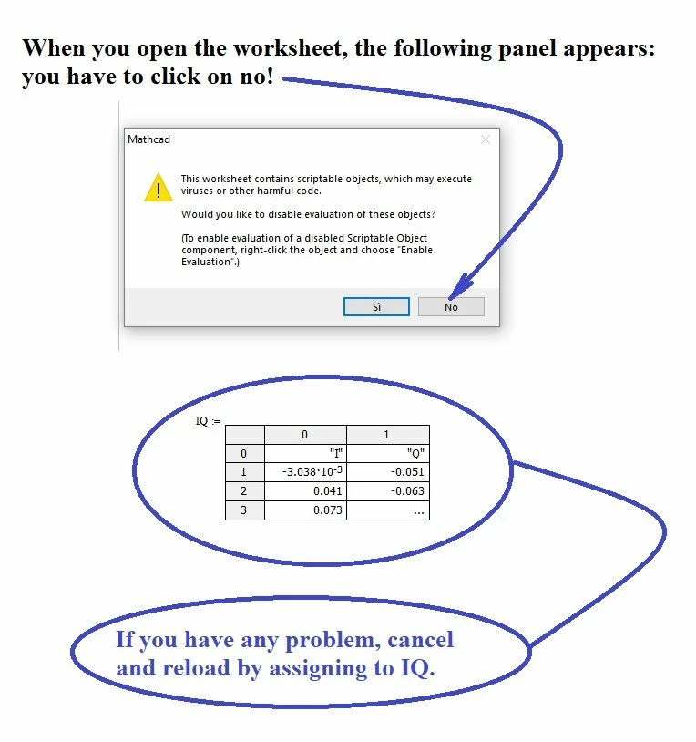

February 24, 2018
I have downloaded the IQ spectra.zip file.
I am struggling with copying the 45001 data points into Mathcad.  I am using copy and paste command and Mathcad crashes.
Initially, I stated IQ:= and then try to insert a table (Insert>Data Control>Table).  But the table option was greyed out
How did you imported the data into Mathcad please?
Maxplus121-VisitorAuthor
February 25, 2018
It's work in win 7 pc 32bitsbut not in win 10 64 bits.

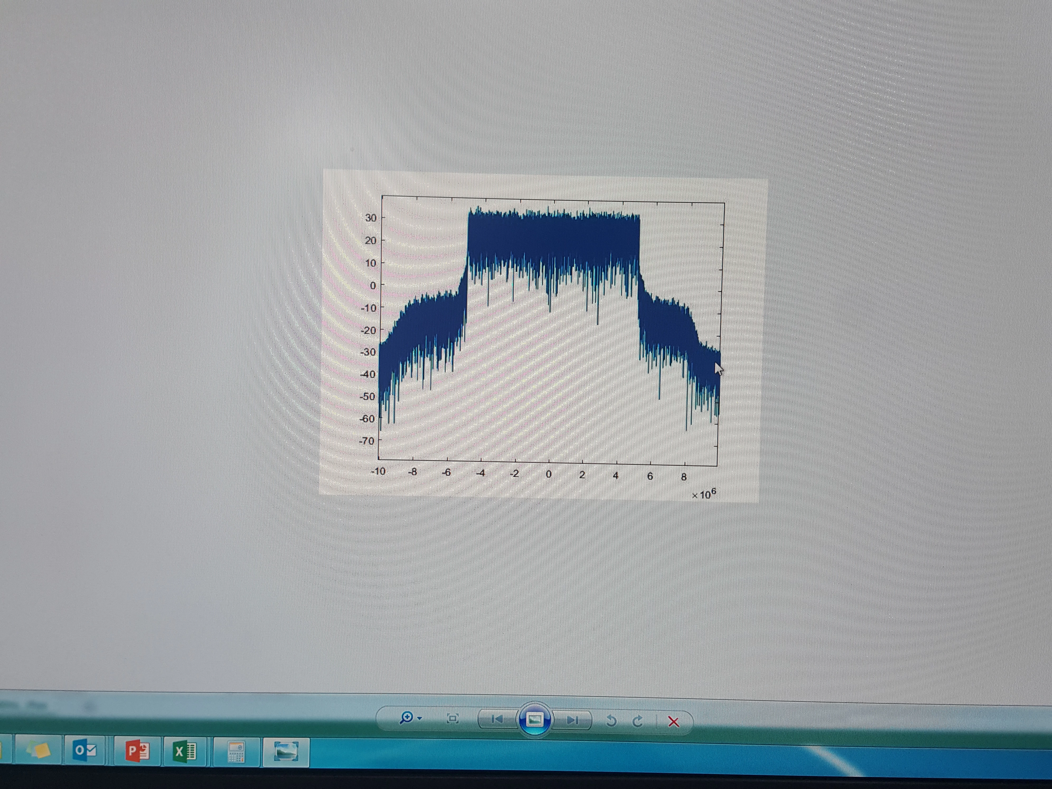

Anyway back to the IQ. I got my sampling time wrong - it should be 2.222E-08.
The IQ.data was captured for 1ms with 45001 points. Therefore sampling freq is 45MHz.
Signal frequency - it's IQ data measured from the analyser in 25MHz BW.
1. I am unsure what FFT bin frequency have been used in your file.
2. Here is the plot using Matlab based upon the IQ data used for mathcad and sample time as before. The plot doesn't resemble the mathcad results. What's going on?
3. What.command was used for FFT shift?

February 27, 2018

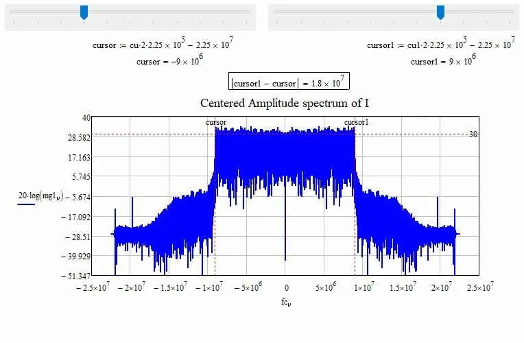

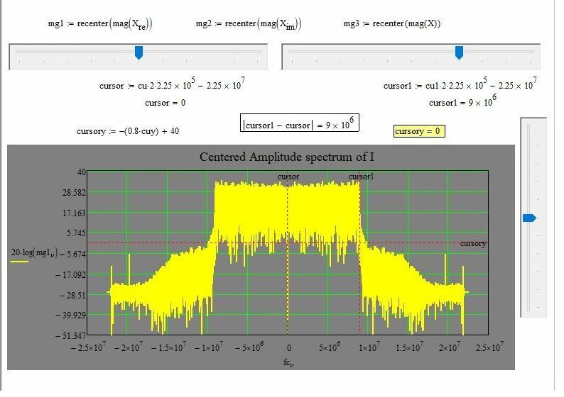

Hi MF,
Thank you for the revised version.
I seem to be struggling with the cursors.  They are not active for some reason even by sliding the rule.
The Cu parameter is undefined.
Also, the import Excel is not working anymore by following your guide lines. The data doesn't get imported at all. I did the following: 1) create table, 2) Right click in table, import Data wizard and selected the file.  It says the file could not be imported for reading.
The way to overcome is copy and paste from my old Mathcad file.
February 28, 2018
