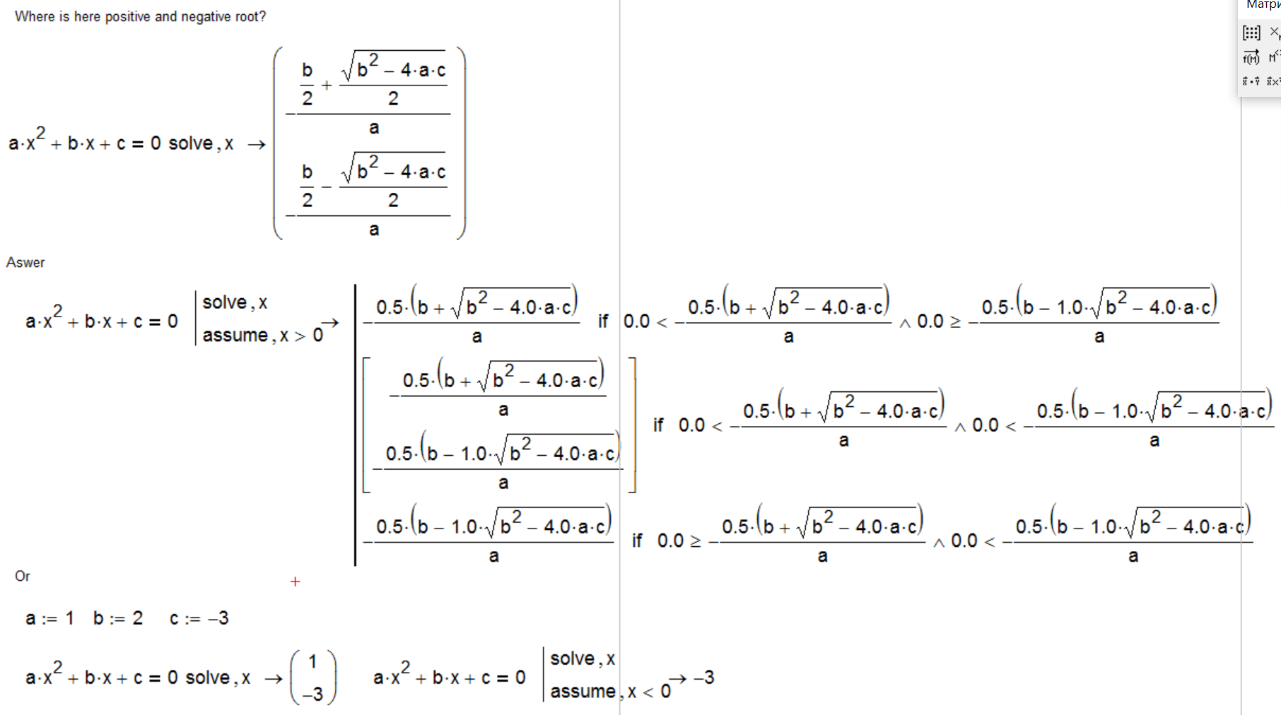

I need to solve the equations for X,Y and Z.  My current issue is I need a single equiation for each to solve the system.  What is happening is I end up with a  +/- solution due to the radical in the denominator.  So how do I get MathCAD to use just the positive value and solve for all three variables?

Thanks for the response. OK I get it. I think the question I am really trying to answer is given the partial derivative of S on my attached script, How can I symbolically solve for X,Y, and Z?

With something like this:

You can't.
I'll demonstrate it on a simpler example. Given:
Please indicate the positive results for x, y and z.
