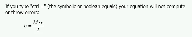

I want to type in a formular in MathCAD just for demonstration, i don't want MathCAD to run or calculate it.
For example following equetions: it throw me error that variable is not defined.
Best answer by Fred_Kohlhepp

23-Emerald I
March 21, 2019

Great!!!
