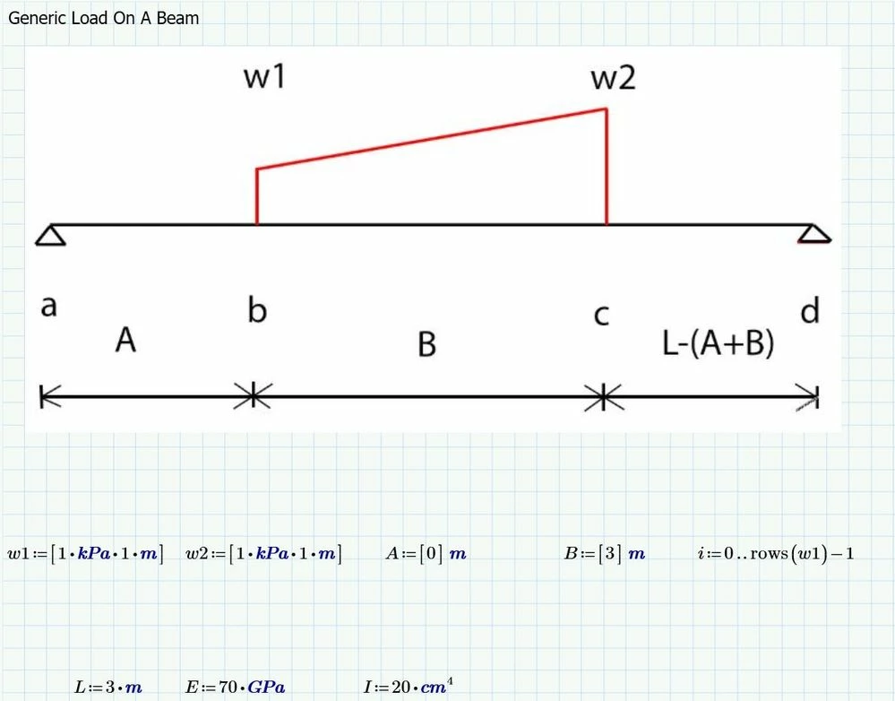

There is a better way for simply supported beams without using bvalfit.
Uses the conjugate beam method to get slopes deflections and moments.
Any number of generic loads can be applied at once.
Just add elements to w1,w2,A, and B matrices that define a generic load to add more loads. Worksheet adjusts to suit.
Any load including point loads as uniform loads over a very short distance can be input.
A,w1 or w2 can be zero.  A uniform load is w1 = w2, A = 0 and B = L.
w1, w2 is force/distance, A and B are distances.
Matrices w1,w2,A,B goes without saying must be the same size.
No check is made that the load distances A plus B are contained within the beam length
