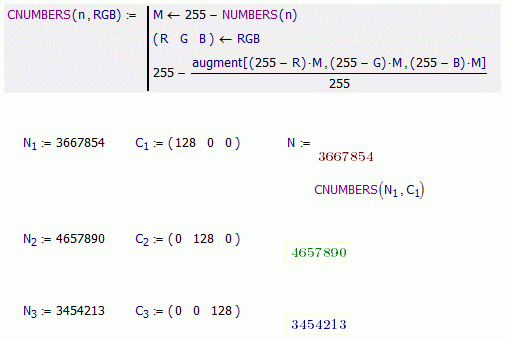

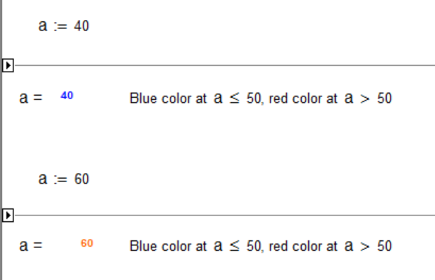

July 23, 2016
Hi. Attached isn't what you want, but can be modify to get it. The attached use a picture tool with grayscale setup, but some color can be added defining the picture tool as RGB.
Best regards.
Alvaro.
July 23, 2016
Some color added.
Alvaro
