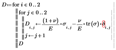

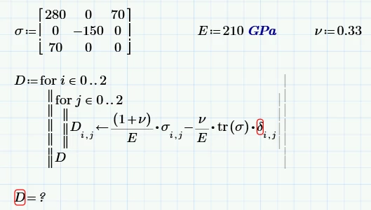

I want to create a matrix using a little program with Kronecker Delta (1 if i=j, 0 if not) however it does not work.
Commands
Where is the mistake?
Thanks!

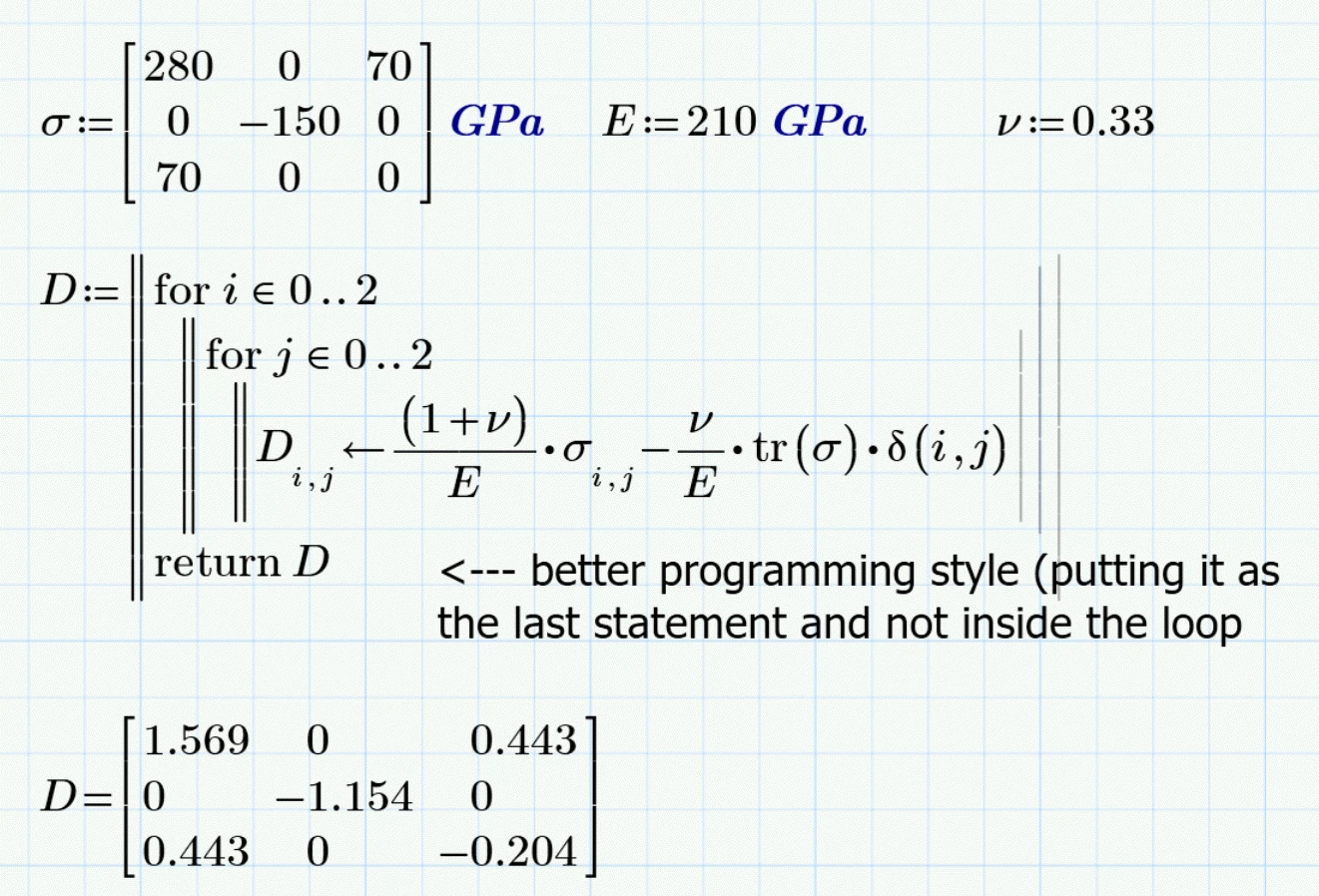

Kronecker delta is a function in Mathcad/Prime, so it needs to be called with parameters 'delta(i,j)'  rather than with indices 'delta[i,j'.
I can't open your sheet (unrar produces an error message), but I should guess that Prime's error message is that delta is undefined...?

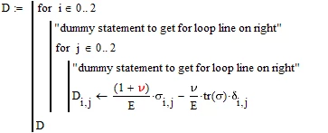

You do not need to increase "j" it happens automatically,
You have return statement for D in the first for loop not outside it.

f.pngOk, but the Kronecker delta is well used?
Look:

The return of D needs to be outside of the for loops
You can use identity matrix for Kronecker Delta

Just to summarize what Luc and Terry already have written:
