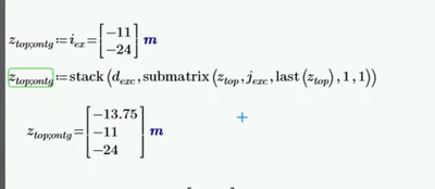

Hi there ,
I want to stack one value in a matrix in the correct order , but when I use stack function I can put it only in the beginning or at the end like this :
I want to put that -13.75 in the correct place which is in the middle in this case . How to use stack function and order the values in the same time

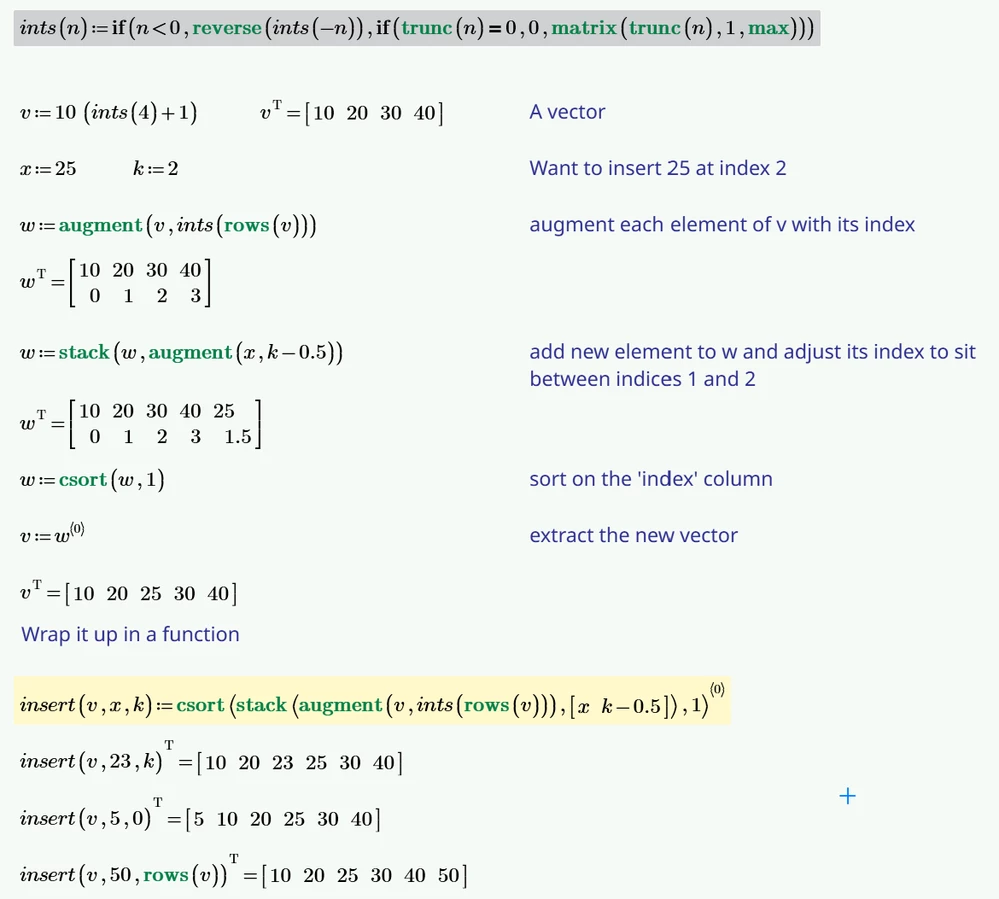

Soup is nicely bubbling (eye of newt; goes nicely with the toasted bat-wing sandwiches), so ... time for one more method.
I added an extra test value to demonstrate that the order of the v & x values doesn't matter, just the indices.   You could also write a program that does essentially the same thing.
Oh, forgot to mention, neither stack nor augment inserts values into an array; they just prepend or append values.
<Caveat>I haven't properly validated the results.  You may wish to do so</Caveat>
Stuart

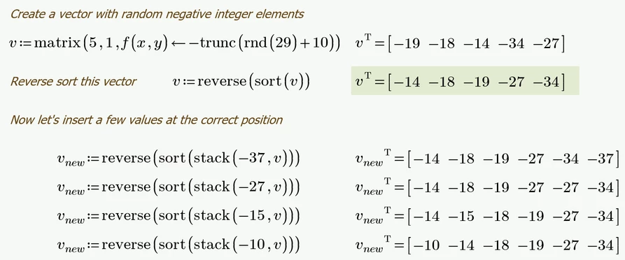

Dec 11, 2025 2:22 PM UTC
Try stack followed by sort. (followed by reverse, if necessary).

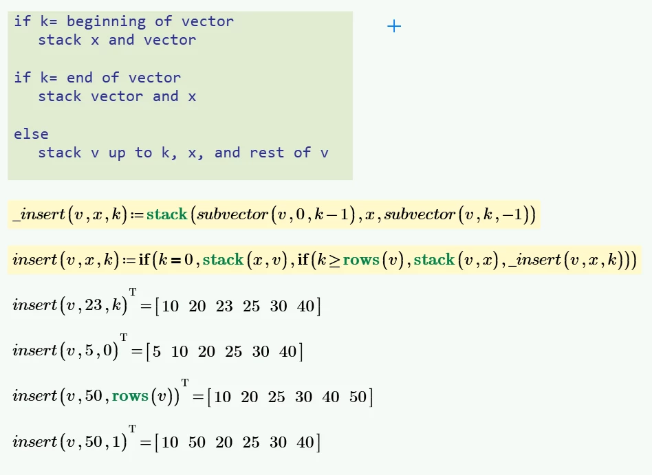

Dec 11, 2025 6:45 PM UTC
Here's one way, provided you want to add an element to the bottom, top, or middle of a vector.
There are other ways that more literally insert an element into a vector.
Stuart

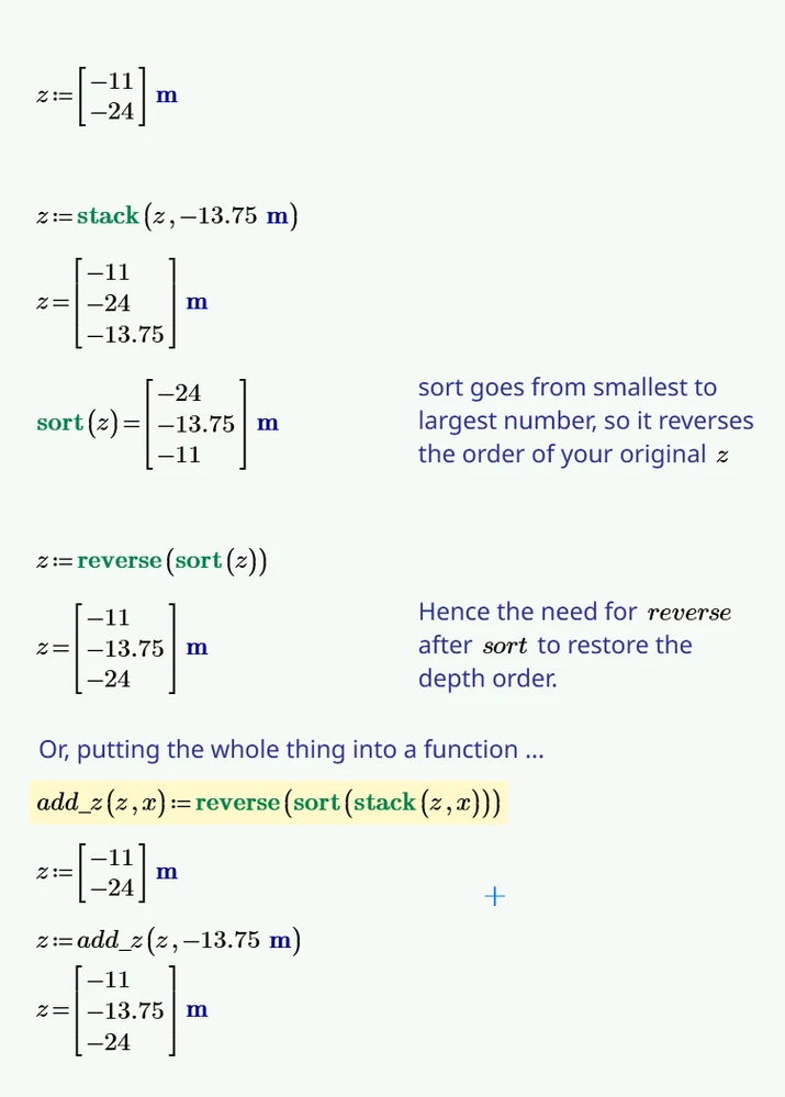

Hi Yusra,
Given that your z vector is depth-related, a natural assumption is that adding a new value should maintain depth-order.   Hence, using my telepathic skills, Alan's suggesting the use of reverse after sorting.  Which leads to a slightly more straightforward solution.
I wasn't sure whether you wanted to retain the depth order or needed to put a specific value at a particular index, hence the more general-purpose insertion suggestion.
Stuart
