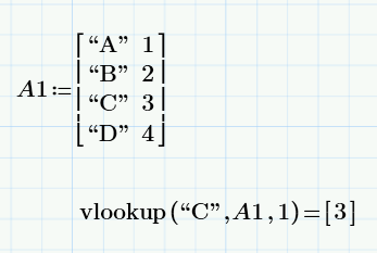

May 12, 2017
You used a table in Prime. Not the same as an matrix:
I hope this helps.
