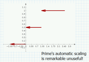

Are you sure this is a valid CDF, as your subject suggests? The appropriate density function would be zero over the whole range with two Dirac's at 0 and 1!?? Is x really a continous random variable or is a rather a coín flip? So it seems to be a discrete CDF where X can only take the values 0 and 1, right?
Concerning the arrows take a look if the attached helps any.

Wow, that's almost exactly was I was looking for. Seems like Mathcad has a lot hidden goods! An example I gave was actually random from wikipedia, mine function is more decent.
