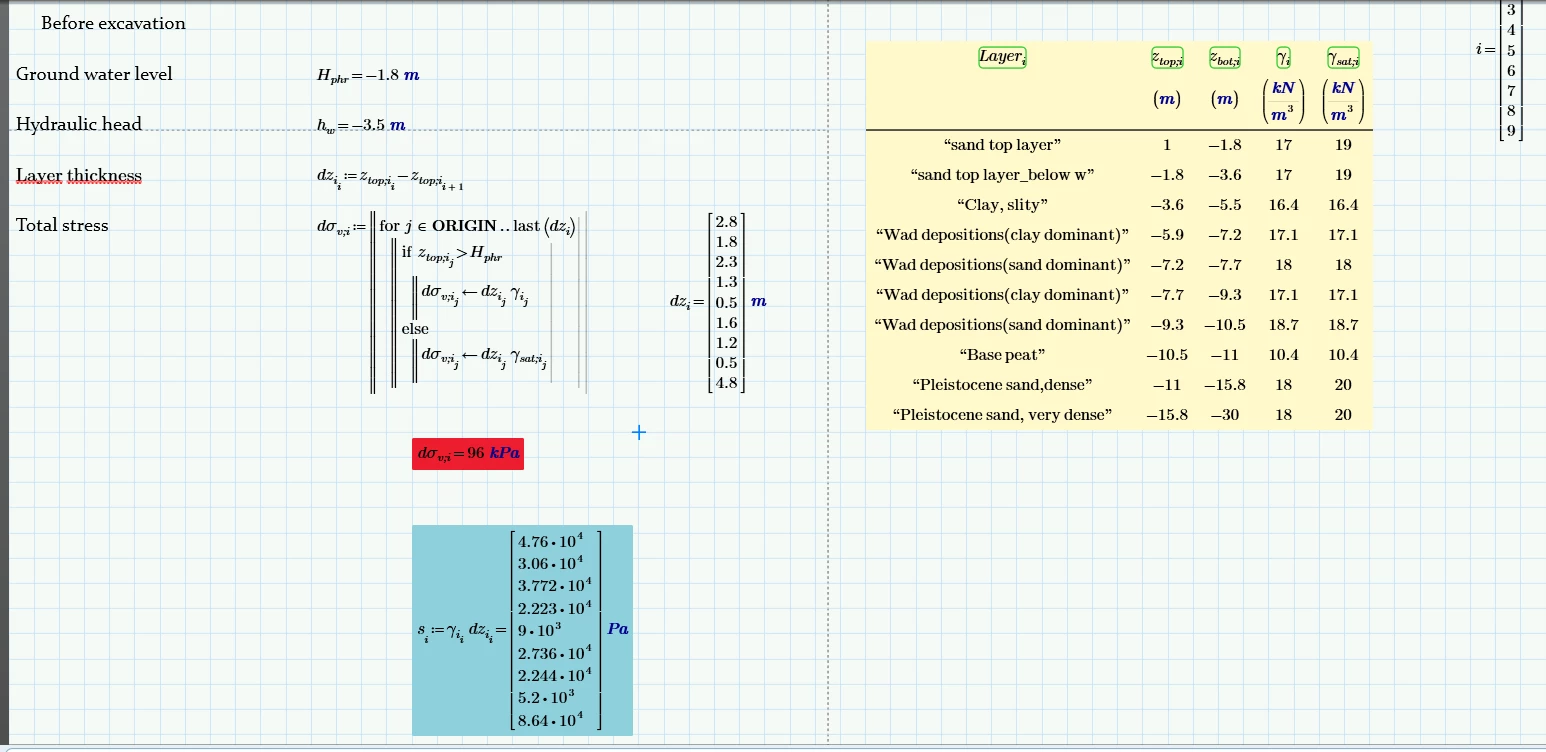

Hi Yusra,
A program result is the last statement executed.
If you add another line at the end with
return dsigma.v;i
You should get the entire array dsigma.v;i instead of just its last value.
Jul 1, 2026 12:51 PM UTC
Please upload the worksheet, not just an image.

Hi Yusra,
return dsigma.v;i
