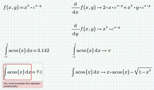

On contrary to real Mathcad (version 15 and below) Prime has no special symbol for partial derivatives, you have to use the normal derivation symbol.
Indefinite integrals can only be evaluated symbolically.
Example file in Prime 4 format attached
