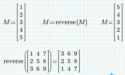

How will I reverse data in a column matrix ???
just consider the following matrix
I want it in reverse , this way -
How can i do this in math cad prime 3.1 ???

Use the function "reverse".
Stuart

Or so

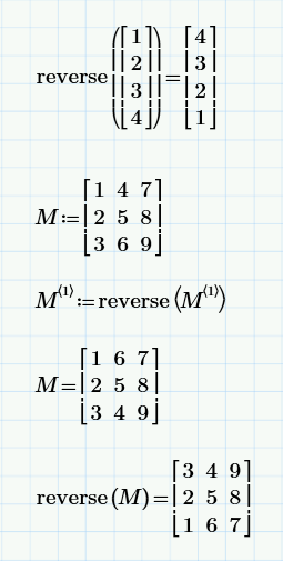

As indicated above , you use the function 'reverse' for that. Note that you can do:
"reverse" is a built-in, ready-to-use function. So there is no need to reinvent the wheel 😉
The built-in "reverse will also deal with matrices, not just column vectors.
