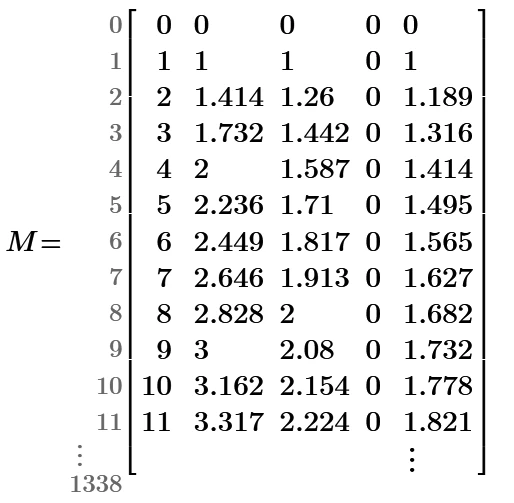

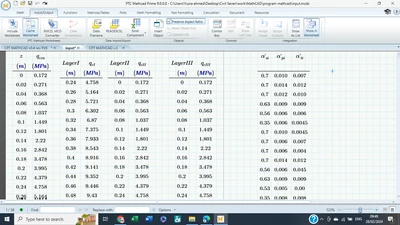

I want to insert huge table with 1339 data in mathcad without using excel . I need the values to be in the mathcad sheet but I don't want to have many pages. Is that possible? I don't want to have 38 pages
Can I just show the first ten rows ?

Note that 'Tables' in Prime are for input only. You cannot use tables to show results of calculations or imported data.
You create a table using the menu and keyboard shortcuts. Are you planning to type all the 1339 data in by hand?
I think you are better off by embedding your data as an excel item. From there you can read the data columns, rows and items into appropriate variables for further processing.

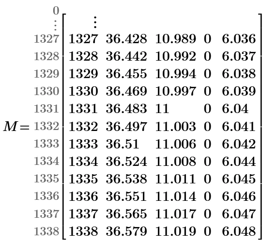

You can't resize a table to just show the first few elements. But a table does nothing more than defining single vectors (= n x 1 matrices). So you could simply define those vectors yourself right from the start. That way you could resize the vector even while you are typing in the values.
But I assume that you don't type in all the values manually but rather read them in from an external file. In that case you could copy and paste the data values to a vector which you later can resize to take up less space and can delete the read-in data, so the sheet still would be self contained.
