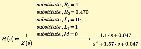

If the values of R and L is below, and the applied voltage is 1 Hz, you can find the answer.
But the conditions are as original ones, Can Prime and Maple solve it or not?

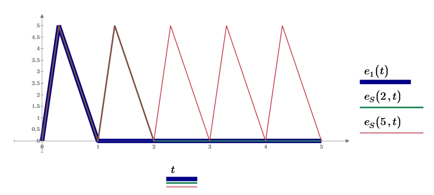

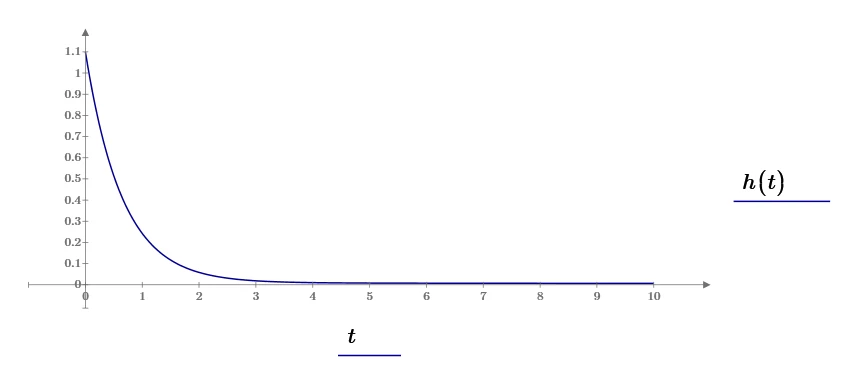

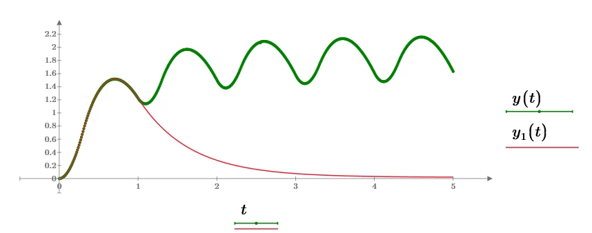

Answer 1.   By using covolution integral for 1 Hz problem.

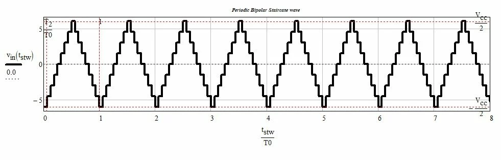

Hi!
It would be more interesting to determine the response to this signal:
