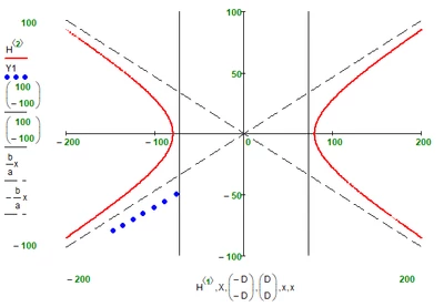

I bring the curve of the second order (hyperbola - red curve) to the canonical form. Why don't my starting blue points end up on a hyperbola transformed to a canonical form. Help me please!
Mathcad 15 in attach.

Instead of changing the value of the angle or using (pi/2-phi) instead of phi you may also just exchange sin and cos in your two rotation equations.
I also wondered why you used the "root" function to calculate phi instead of a direct calculation

1) You used X instead of X1 in yor second plot
2) The center of the original hyperbola is not in the origin, so you have to translate X and Y by x.o and y0 before you rotate them
3) You angle phi is wrong. Here you see the original hyperbola (matrix H) translated by (x.0; y.0) and rotated by your angle phi
The correct angle to rotate is not 42.659° but rather 90° - 42.659° = 47.341°.
Using all these corrections we get

Sorry, I did not save and keep the modified sheet.
But only very few changes are necessary and they can easily be taken from the pictures, I think.
  • Simply add the angle to 90°,
  • add the displacement at the calculation of X1 and Y1 as shown
  • and use X1 instead of X in the plot.
That is all that is necessary.
