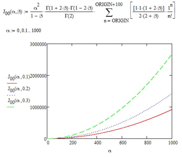

I am attaching a worksheet requiring the use of a hypergeometric function 3F2 as may be seen. I am at a lost in setting this up in Mathcad 15.
Anyone that can help would be greatly be appreciated.

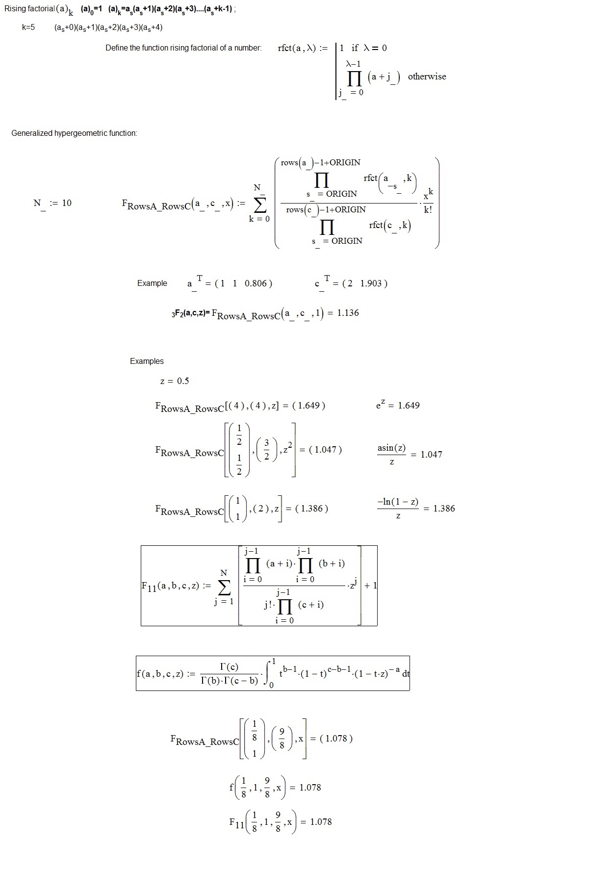

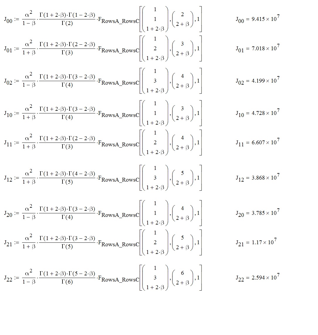

So I tried to create the function corresponding  to that you want.
These are the results of my calculations following the textbook of mathematics "Bronstein-Semendjajew". They are contrary to the builtin function mathcad "hypergeom".
Greetings
FM
Based on the previous results, we get:
Best regards
