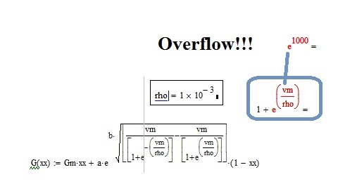

I am getting error as 'All evaluations resulted in either an error or a complex result'
Hi all,
I am trying to plot the graph for vm = 1, 2.
But, I am getting error as 'All evaluations resulted in either an error or a complex result'
when I plot for f(x) vs x.
When I do the same program in Matlab for vm = 1, 2, I can able to get the result with no error.
My question is, in mathcad, is it difficult to plot for vm = 1, 2 ?
I attached my code below.
Could someone help me.
April 21, 2017
You are right Werner.  Careless of me!  I've attached corrected file.

April 21, 2017
April 21, 2017
Needs to be expressed as in the attached.
Alan

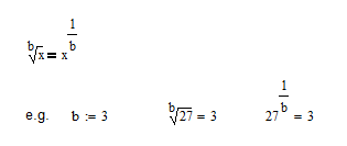

April 21, 2017
But what vetri had typed was not the b-th root but b times sqare root.
Not sure what he meant, but I guess you guessed the correct interpretation.
April 21, 2017
However, in the first form, b must be an integer.  In the second form this is not necessary.
Alan
