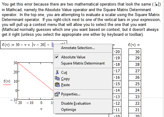

I am getting error as 'this value must be a matrix of scalar elements'
I attached my code below.
Can anyone help me.
Thanks in advance.
Can anyone help me.
Stuart
