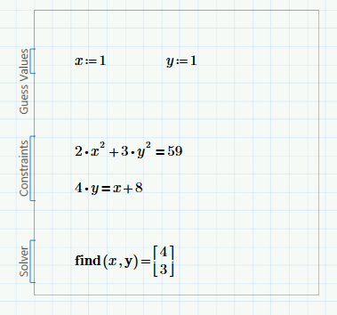

I am trying to use find function, but not able to use it properly it gives me error. pls someone help me.
I have taken this problem from tutorial but don't know what was wrong in this.

I am not able to get what mistake i have done in this, I tried for some another equations also but getting same error.
so please can some one help me ?

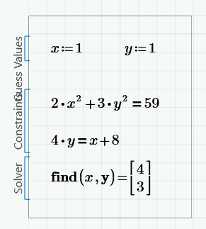

It's difficult to tell from the screen shot, but check that 'find' has the correct label; an incorrect label will result in the error message you see.
I've typed it in to my Prime 3.1 and it seems to work OK.  If find's label is correct, please post your worksheet so that somebody can have a look at what's actually there to see what the problem is.

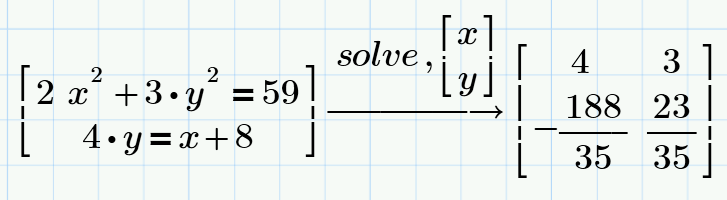

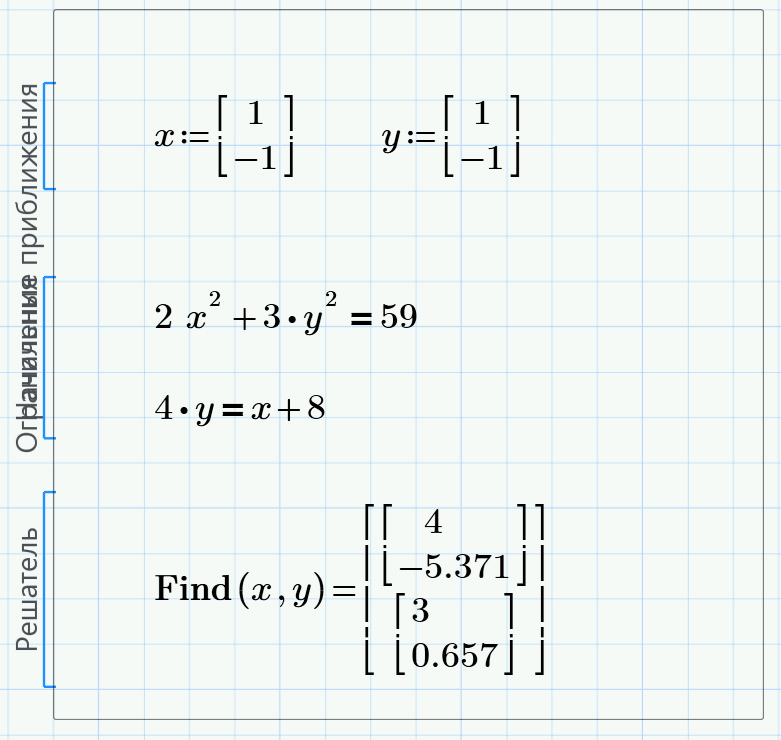

All roots
November 28, 2015
Symbolic solution
