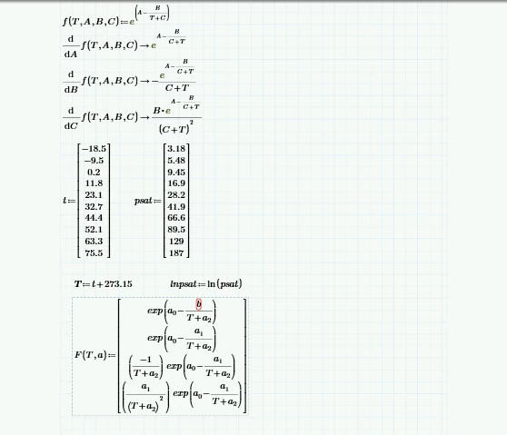

i am stucked with a comment 'The variable is undefined . check that the label is set correctly.'
plz suggest me i am going to data analysis by regression method
We don't see if you defined b and if you did, we don't see how you did it.
Its hard to impossible to debug a picture.
If possible please post the worksheet.

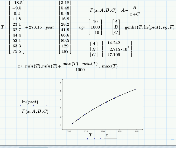

In Mathcad Prime define partial derivatives for the subsequent genfit using is not necessary. See attach.
Viktor
Hi Saru.
Although the Viktor answer seems to me very correct, the error message in your function is just because b it's wrong: it could be a[1 instead.

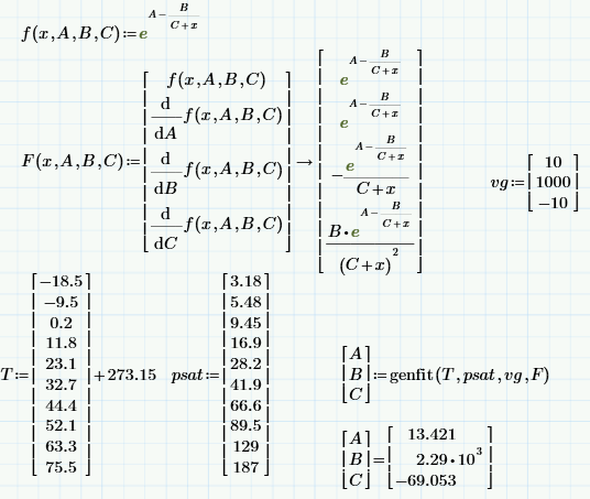

Solving with partial derivatived expressions.
Viktor

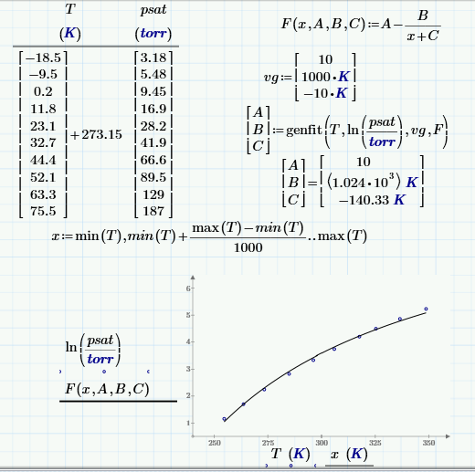

...And solution with units.
Viktor
