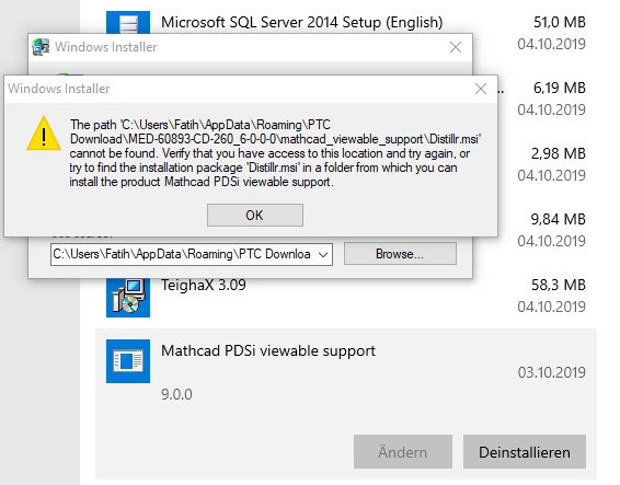

i installed PTC Mathcad Express to quickly check a file. I couldnt open it so i wanted to delete Mathcad. I am not able to deinstall it until now. I get this issue at the attached picture. However i can deinstall the programs "ptc mathcad prime 6.0.0.0" and "ptc diagnostic tools. I even reinstalled everything, still i get the same error.

I don't have that file on that location, but I am able to de-install the same version (9.0.0) of the PDSi.
Maybe the difference is, that I left Prime sitting on my computer....
An explanation for the error you have could be that in order to de-install the PDSi, another file of the Prime installation is required. (Error messages aren't always extremely accurate.)
You may want to try the following:
Re-install Prime 6 express. Then de-install the PDSi, then de-install Prime.

it was indeed a xmcd file. I could solve my problem. I had to remove to PTC folder manually from my disk and then i was able to deinstall mathcad pdsi viewable support via CCleaner. I will buy MathCad as Student via my university shop anyway since i need it this year in a course. Thanks for the fast replies.
