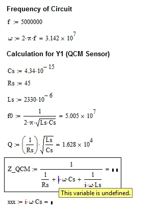

I am doing a calculation of RLC circuit in MathCAD, but I am facing to a problem with usage of "i" ( notation of complex number) as shown bellow:
Please help me to treat this .

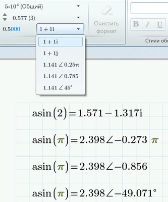

November 28, 2018
Mathcad Prime - new in complex number formatting

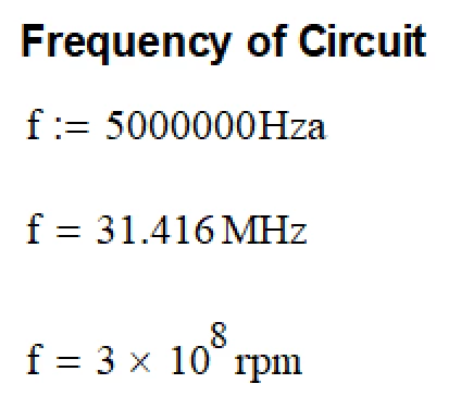

November 28, 2018
See please - with units

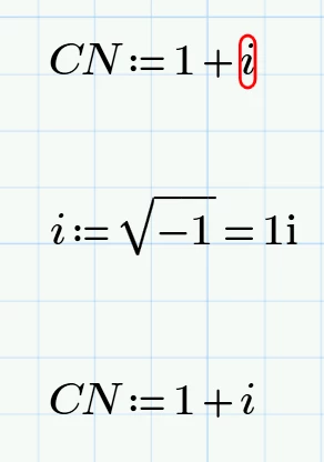

December 27, 2018
Works for me if I define j  as the square root of -1
December 27, 2018
In real Mathcad (=MC15 and below) I would strongly advise against doing so, but in Prime I have to admit that the imaginary unit displayed as 1j or 1i simply looks too ugly and so I understand that defining j:=1i or something like that makes sense.
December 30, 2018
Yes, in "Real" Mathcad 🙂 I'll never assimilate the Primes. I have always defined the imaginary constant explicitly, as it gives me the confidence that I'm using the values I want. Why do you think this is bad practice?
