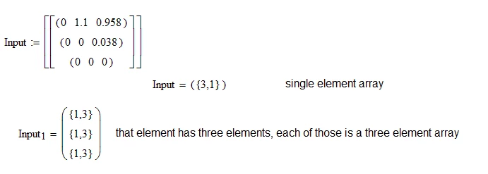

You've created a mess:
So Mathcad hand VBscript an array with a single element with three subelements each with three subelements. . .
No wonder it's confused.

That parenthesis was created  using
instead of creating an array
