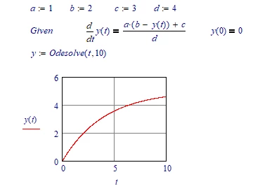

Most probably because you've used a range in the Guess values.
Does it work if you delete from the Guess values:
 L:0,1..LEND
Additionally: you HAVE to provide one initial condition for your C02L function. E.g. C02L(0)=0...

There's no doubt. Mathcad (and Prime too) really CAN solve this differential equation numerically. It's just that you have tro set it up correctly.
I can't show you how to do it in Prime (I'm limited to Prime express), but in Mathcad 11 it goes as follows:
I know that the way to set up a solve block for solving differential equations differs between various mathcad versions. In Mathcad 11 it's different from Mathcad 15, and Prime uses a completely different structure.
I suggest you look up the help information regarding Odesolve and work out some simple examples, to see that it really works, THEN correct your sheet....
