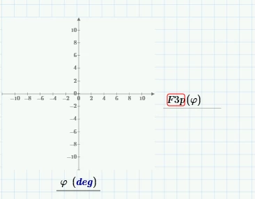

I encountered a problem "The value must be a real number" when I try to plot a graf
I encountered a problem "The value must be a real number" when I try to plot a graph. Please help me figure out the problem. I use Mathcad Express Prime and I have attached the file.
May 15, 2025 5:45 AM UTC

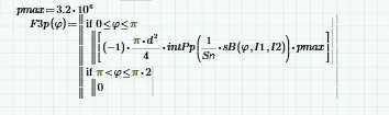

you must not use [] square brackets. Please fix your definition.
Add range before the plot.
