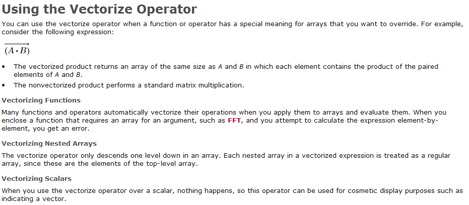

You need to user vectorization! Thats a special Mathcad operator:
Excerpt from the help:

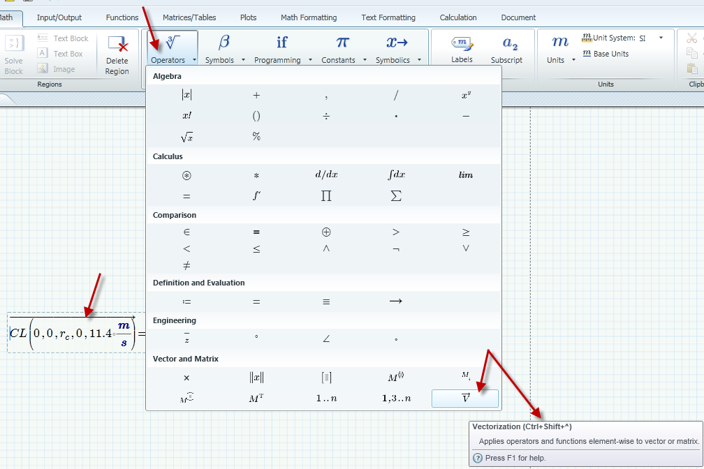

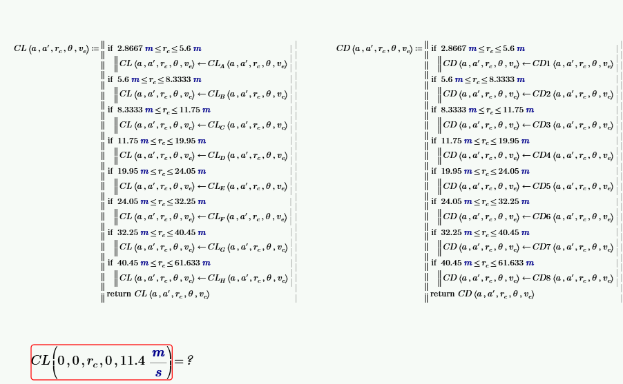

And I got error here
I got massage about scalar error here
r.c is a vector but you compare that argument to a scalar in your function CL. This obviously can't work.
If you want the result for every element in r.c collected in a result vector, you have to use the vectorization operator over CL(.....).
