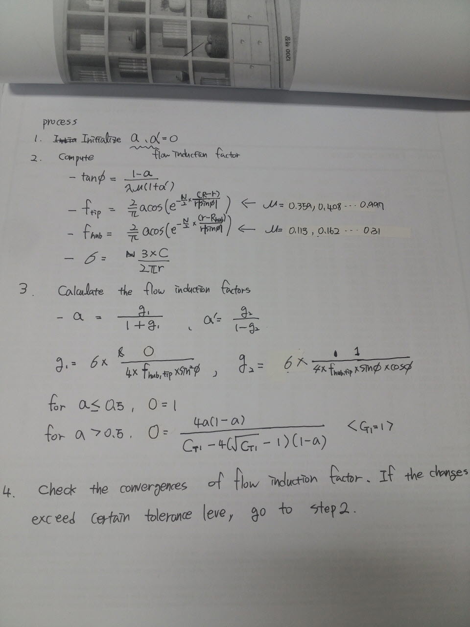

I have questions
I tried to finish following process. But I continually got error when I coded.
So I uploaded process steps. and I also attached my files.
I am early step about studying 'mathcad'. So I want you to help.
