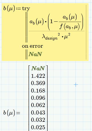

I have some questions
Hello I write to want to know about my question.
I have a problem. you can know to a picture on upper.
I read error massage and I knew why error is generated.
error is said that it is not possible to divide 'zero'.
Could I slove following error?
I attached my files.
Thank you for reading my question

While the best way probably is to avoid my=0 alltogether, another workaround is the redefinition of the function b() so it catches the error and returns a dummy result or, as shown below, a NaN (Not-a-Number).

You get a divide by zero either when mu=0 or when mu=1. It's clear that as mu approaches 1, b(mu) approaches 0, so that's easy to fix. However, as mu approaches 0, b(mu) rises asymptotically to infinity, and when mu =0, b(mu) is undefined. So the real solution is to not calculate b(mu) for mu =0, because it's meaningless. If you don't want to do that, then make the function return NaN for mu=0.
