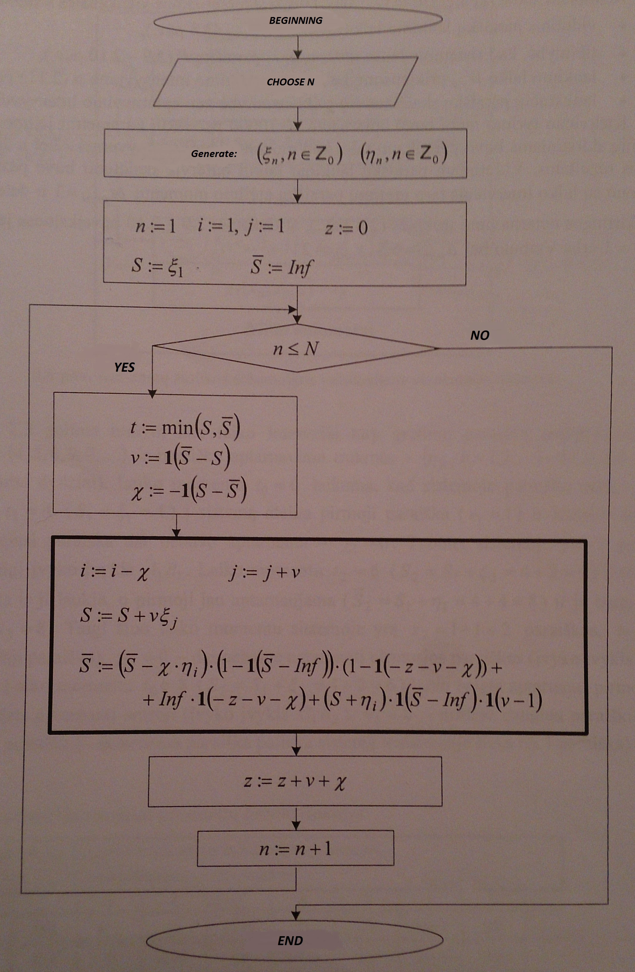

I keep getting the error: This array index is invalid for this array
I tried to write a program using the attached algorithm. However I keep getting "This array index is invalid for this array" error. It occurs in various places when I try to fix it.
RichardJAnswer
You have not assigned a value to z[n, only to z[n-1.
RichardJ19-TanzaniteAnswer
Yeah I just figured this out few minutes ago. And the 'N=1000' value was unreasonable as well.
