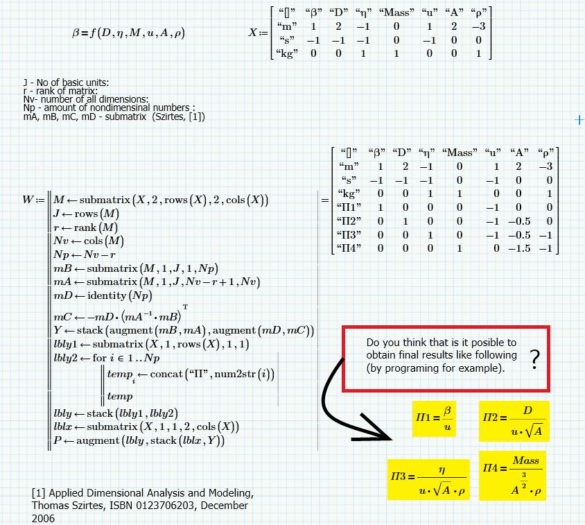

I'm wonder if it posisible in Mathcad
I trying to simplify a Dimensional Analisys (by Szirtes)
It is nothing important but I wonder if it possible in Mathcad.
It seems that in Maple it easy, but Mathcad has still more friendly interface.
wzel
I enclose file but unfortunately in Mathcad Prime 3.1

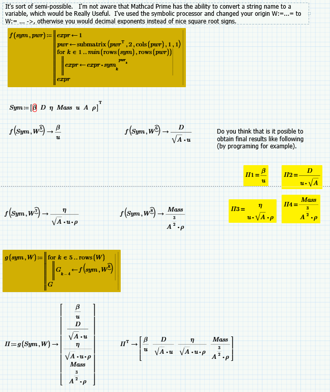

Maybe ...

I have tried the lookup functions to  find values in arrays.  It may simplify the program.
