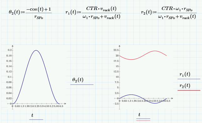

I need help on how to solve this DIFEQ
I'm trying to solve a set of differential equations, I removed the integral, but I don't know what exact information I'm missing. I'm getting the error message "you have too few equations".
Also, is it possible to make mathcad solve this using laplace method?

I'm not really an expert in Mathcad's numeric DE solvers, but I know this:
You want to find three functions of t: r1, r1 and q2. Then you need three independent expressions to describe them. Apart from the big one involving all three functions, you have two more in the Guess Values section. If you move them down to the Constraints section that might help.
Also I think you are lacking one more initial condition.

If you manipulate the equations as Luc has done you will see you really only have one ODE, namely that for theta2.  This is easily solved, analytically (because vrack(t) is just sin(t))  to find the solution given in the image below, assuming the initial condition is correct (the final condition is incompatible with the initial one).
Because r1+r2 = constant then (dr1/dt)^2 = (dr2/dt)^2 and these cancel (see Luc's equation above) to leave a simple expression for r1 and r2 that can be solved, in conjunction with r1+r2=constant, to get the expressions in the image below.
