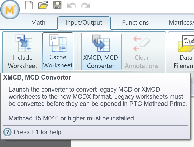

If you have Prime 4, then you also have (the right to install and use) Mathcad 15, which is required for the conversion.
You can use the same license that you used for Prime 4, to license Mathcad 15.
Once installed, you should be able to convert your file from the menu option in Prime.

Yes, i knew about that , but the problem is that appears transparent because i dont have mathcad 15 . Now i'm installing it so i think the problem was that . Thank you!

Thank you guys. The problem was that i have no mathcad15 installed. I recently install it and works !! LucMeekes‌ Valery Ochkov‌ @WernerExinger
