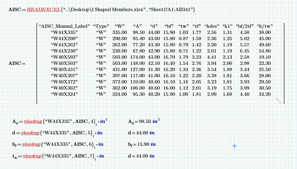

I have a matrix of steel shapes and the corresponding section properties.
Currently for each section property I am using a vlookup function.  This requires I type in the shape of the beam inside each command every time.  There has to be a way to combine a vlookup and extract an entire row based on that lookup item.  I assume I could then put the extracted items into a single column matrix and have each passed into the variables.  This would allow me to only type the shape into a single lookup function.  I'm new to Mathcad so I'm probably overlooking the obvious, but I have searched for a solution and can't find one.  Anyone know of a way to do what I am trying to do?

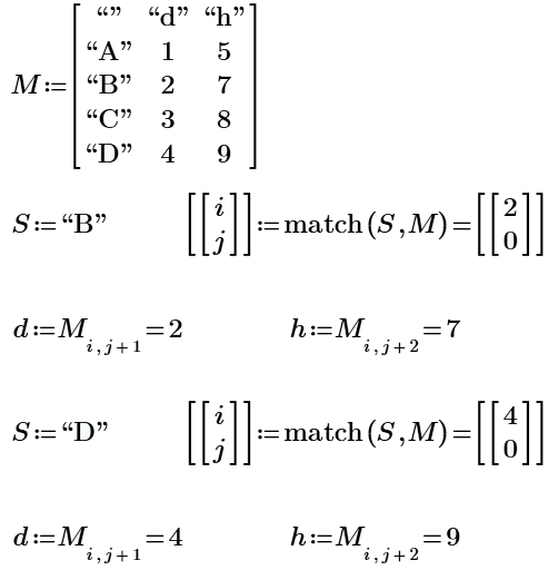

Use "match" to obtain the row index for specified shape.  Then, use the matrix row function to extract it.

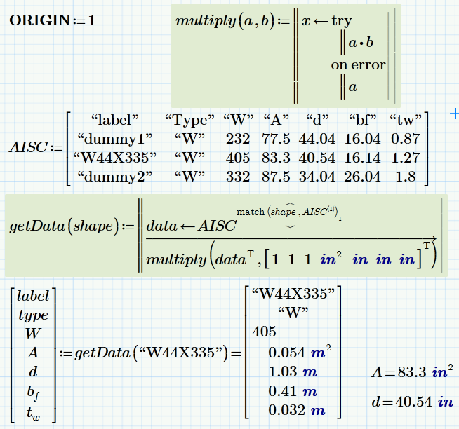

1) You could define a variable for your shape like
shape:="W44X335"
and later use this variable in your vlookup commands.
A.g:=vlookup(shape,AISC,4)[1*in
2) As Mark already wrote you can use match to get the row number, like
rownr:=match("W44X335", AISC)[1[1
or to just search in the first column
rownr:=match("W44X335", AISC^<1>)[1
Then you could Primes row selector to assign a variable the full row of data.
You may even multiply this row (you would have to use the vectorization operator!) with a row vector consisting of the appropriate units for each column and assign the result to a row vector consisting of the Mathcad variable names like A.g, f, etc. and you have your single variables with just one command.
The attached may be helpful:
EDIT: Haven't seen Marks last reply before posting my own. I would prefer his "ApplyUnits" over my "multiply" 😉

Use match function to find index of row and column of the steel function shape label, then use the mathcad function to extract a row based on the idea of row returned form match function
