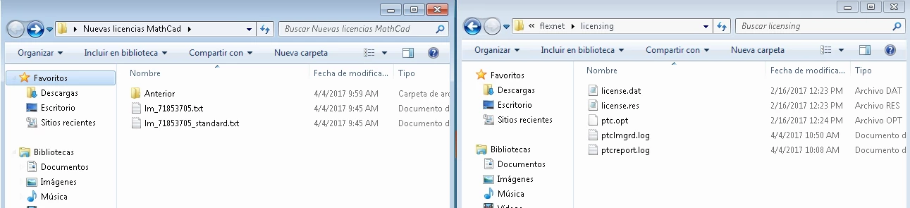

I received a new license files because we purchased two new licenses of the program. I currently have the file on the server but I do not know how to load it. Could you please help me?

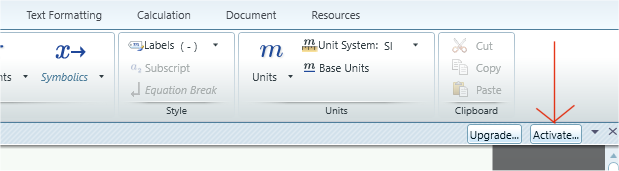

I guess you just install Mathcad and during installation it will ask for your license, then you point to the right file.
Do the same for Prime if you need that.
Note that your license is valid for Mathcad 15 and for Prime (You should be able to activate one installation of each of those two application with a single license file).
If you've already installed Mathcad 15, I think you'll find the licensing button on the Help->About-screen.
If you've already installed Prime, use this button to license it:

it looks like you bought floating licenses.
On server machine
  • turn off firewall temporarily
On client machine
  • install Mathcad Prime
  • launch Mathcad Prime
  • click on the PTC Mathcad orb, then Options…, and then the License tab
  • enter path to license in form ... 7788@licenseservername
On server machine
  • turn on firewall
  • define firewall inbound rule enabling inboud communication for lmadmin.exe, lmgrd.exe, ptc_d.exe
