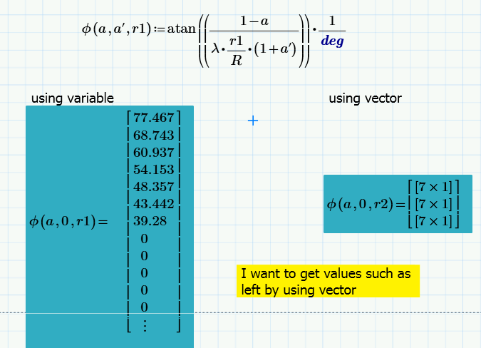

I try to change "vector"
I try to chang "vector"
But I am seriously having a problem.
This is a problem that I feel difficult.
I want to get left values, not right.
But If I use "vector", I get right value. it make me sad...
I want to get advice
23-Emerald I
Nov 9, 2014 1:57 PM UTC
Let's see:
You define a as a range,
And you define a' as a range
Then you ask a function to evaluate over those ranges and a vector. And it did, returning three vectors.
Uncollapse your nested matrices and see your numbers.
