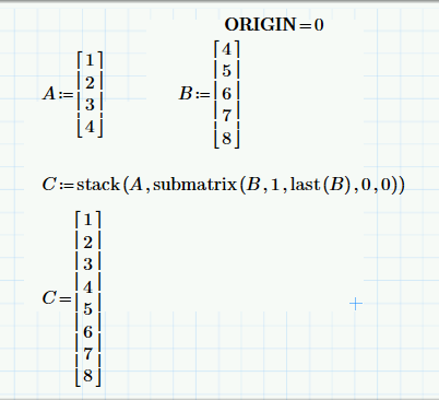

I want to combine different 2 vecctors
Hello.
I had a question.
I want to make "C" by plusing A and B
It means that "B" from 2 rows(5) should add under 4 rows in "A" automatically.
Could you help me?

C:=stack(A,B)

Thank you for helping.
But I want to get result's values without duplication.
I got same value "4"

And sorted, too?
There will be no specific command in Mathcad to do so and it will require a samll program. You will have to specify your needs in more detail. As it looks to me now its not a matter of combining two vectors but rather a problem of removing duplicates from a single vector. I think you will have to provide more different examples to make it clear.
E.g. what about A=(3,6,3,2) B=(7,1,7,3) What result do you expect? C=(1,2,3,6,7) or C=(3,6,2,7,1) or what else?

How about this solution:
