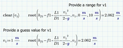

Sure, you can use the root function. With a guess value:
Or the 'bracketed' form, where you provide the limits of a range within which to find v1:

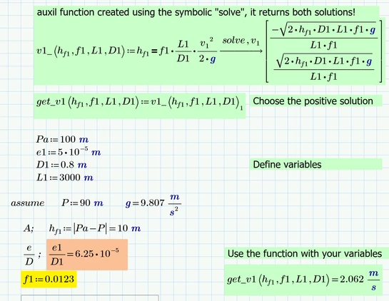

And you can (first) solve the problem symbolically, to find both solutions:
Then fill in the data:

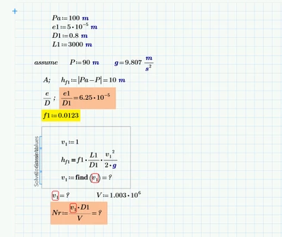

Mar 14, 2023 6:31 PM UTC
Yes you are. You forgot to set the unit for v1 in its guess value
v1:= 1 m/s^2

Is there any other way to find the velocity without using the solve block?
Mar 14, 2023 6:47 PM UTC
How about using the "root" function in one of its two flavours ?
You may also use the symbolic "solve", but I would suggest doing so before you define your units and create a function in all unknowns for v1.
