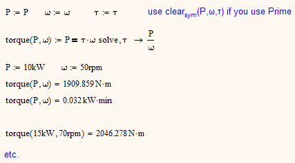

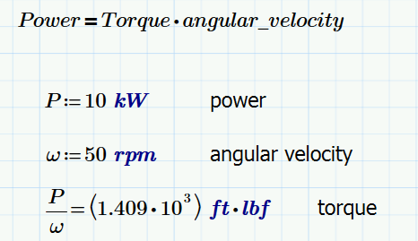

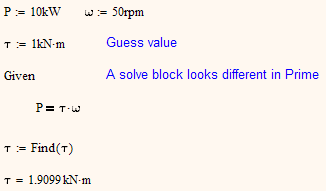

I want to find torque from standard power formula without changing equation to t=p*30/(pi.n)
I want to find torque from standard power forumla p=2piNT/60
i tried like
p=10kw
n=50 rpm
how to find T
Without making equation relating torque like
T=p*60/(2piN)
Werner_EAnswer

If you need the calculation more often with different arguments, you might consider creating a function for torque
In case the formula is more complicated and cannot be solved symbolically anymore, you will have to resort to a numerical solve block:
and of course you could turn this solve block in a function, too, if you like. You would simply write torque(P, omega):=Find(tau).

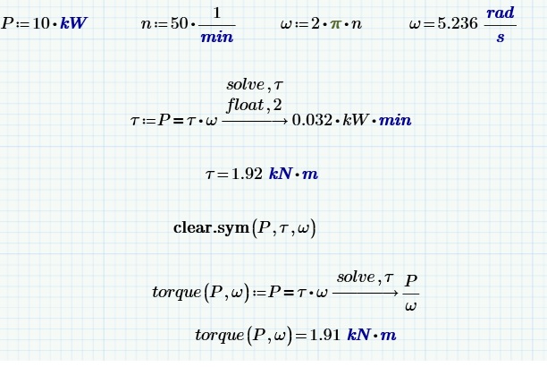

As you could see - when you define a variable with unit rpm, you already define omega = n* 2pi, not just n. And there is no need to manually convert minutes to seconds as Mathcad takes care of the correct units anyway.
After all, the suggested methods all seem overkill, as it would be to easy to simply do
but I guess you have more complicated formulas in mind which cannot solve for a variable that easy.
Werner
BTW, using the symbolical keyword "float" is dangerous and usually not recommended as it affects not only the display of the result but also the precision of the whole calculation. So you might lose significant precision!

Also suppose i want to shuffle the variable required, i.e. standard formula is P=w*T.
1. Torque for Shaft 1 (T1)
2. Power transmitted using (T1).

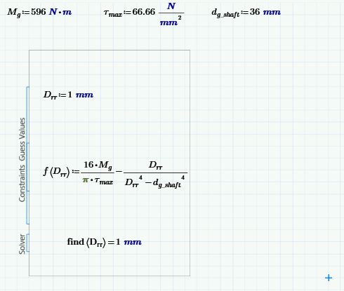

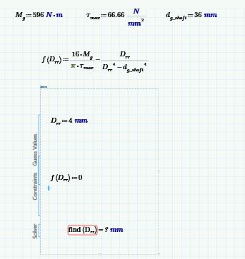

Now can tell how to find the unknown variable Drr..it get complicated to go simplify...
or
September 2, 2016
Your first example just returns the guess value because there is no constraint, just a function definition.
Your second example looks like it should work. We don't see what the error message is and can't play around with it as you didn't attach your sheet.
It looks like your formula for f is wrong, as your first summand is of dimension length^3 but the second is length^-3 !!

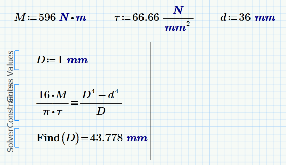

Werner_E25-Diamond IAnswer
September 2, 2016
Maybe it should be that way:
And next time please attach your sheet (additionally to your screenshots).
