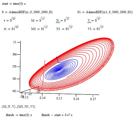

I want to combine two 3D plots (M, N, V) and (M1, N1, V1)
into a single 3D plot in Mathcad.
I attached my code below.
Could anyone help me
Thanks.
@terryhendicott wrote:
You are plotting way too many points in the combined plot 400,002 points.  This will take Mathcad forever to plot.
Enclosed is a program that samples every five points of M,N,V and M1,N1,V1 into shorter arrays Ms,Ns,Vs, and Ms1,Ns1,Vs1.  It takes Mathcad minutes to show finally the plots of these two curves in a 3D plot.  Each plot can have its own appearance.  Here I chose red and blue scatter plots.   I am not sure how long it will take if you leave MathCad to plot the 400,002 points
The bottom left of the 3d graph is like this (Ms,Ns,Vs),(Ms1,Ns1,Vs1)  Hope this helps
Without undue difficulties, we can do a quick calculation if you reduce the number of integration steps.PhasePortrait.png

See attached file.
terryhendicott

vveeran4-ParticipantAuthor
Thanks a lot Viktorrobov for your reply.
But, I have some doubt in plotting 2 3D plots.
When I draw 2 3D plots,  plot 1 is plotted using lines from appearence tab
and the plot 2 is plotted using wireframe from appearence tab.
In the appearence tab, I can't find lines option in plot 2.
I want to know, 'How to choose lines options for plot 2 from the appearence tab ?'
In plot 1, I saw the following in the appearence tab,
Line options
* Lines
* Contour lines
*No lines
whereas in plot 2, I saw the following,
Line options
*Wireframe
*contour Lines
*No lines
How to choose lines from the appearence tab in plot ?
I attached the code here.
