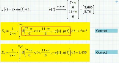

I want to know the reasons of my Mathcad sheet errors.
Using Mathcad the average value of f(t) and convolution of rectangular waves have wrong results.
I want to know the reasons.

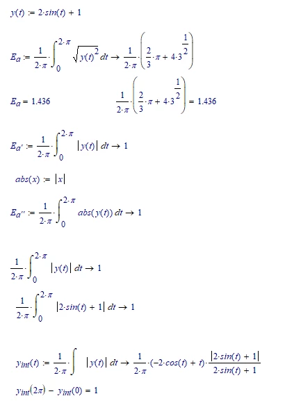

|  |, if etc - not for symbolic math! Symbolic mathematics (and nature) does not like sharp corners!

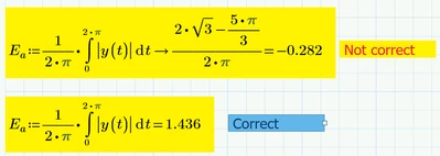

Jun 13, 2018 9:55 AM UTC
If the symbolics does not "like" sharp corners it should say so and not return an awfully wrong result.
What we see here is a clear severe bug of Primes symbolics (= MuPad) which is also present in real Mathcad.
The expression should either be not simplified at all or return the correct symbolic result
If you are under maintenance  you may consider reporting this bug to PTC but don't expect a fix within a reasonable time.

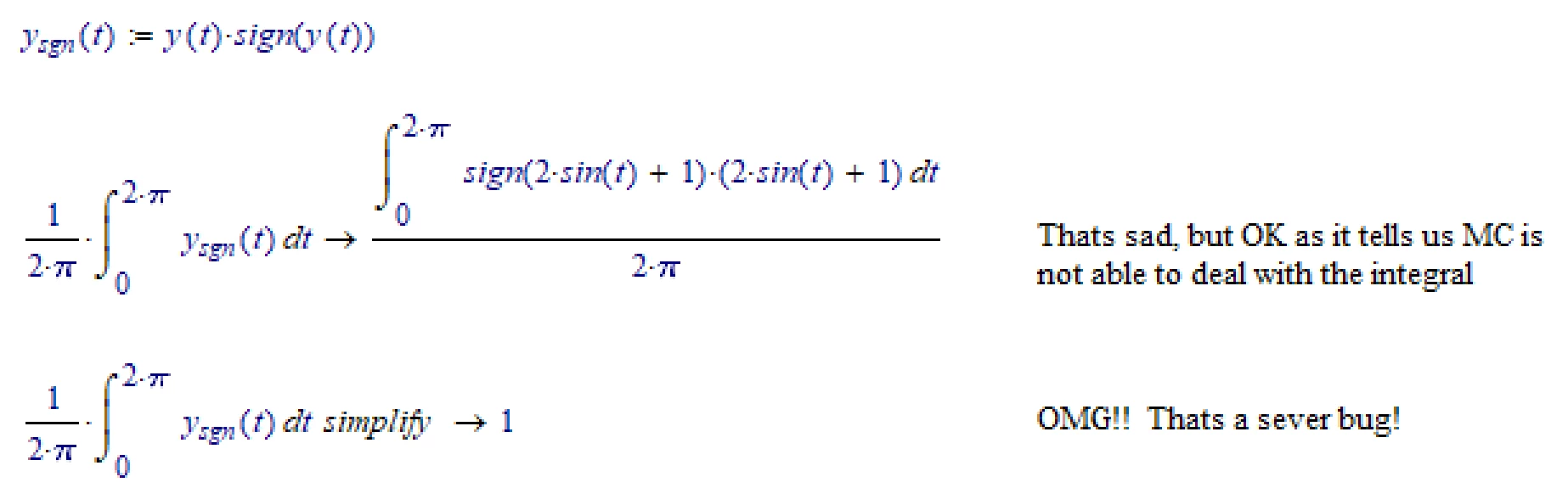

Jun 13, 2018 4:53 PM UTC
At least Maple got the correct symbolic solution when replacing the absolute value by root of square.
Nevertheless I am surprised that even Maple in MC11 has problems with the absolute value in a way that it returns a completely wrong result. This should never happen in a Math software and I see it as a very severe bug (which will not be fixed, I know). If a software returns no result because its not capable to find a solution, then this may be a sign of quality (or the opposite of it). But returning a wrong result, thats an absolute no-go!

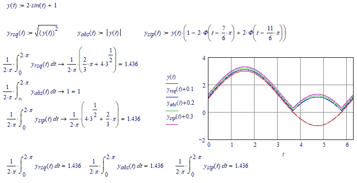

Jun 13, 2018 8:25 PM UTC
What happens in Prime/Mathcad 15 (with symbolic evaluation) if you take the symbolic equivalent of the if() statement: the Heaviside step function:
(Of course, as shown, numeric evaluation gives the right answer with any of the three ways to make the function positive)

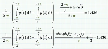

Jun 13, 2018 8:36 PM UTC
Similar results in MC15. Heaviside works with symbolics, too.
The drawback of course is that we have to manually derive the points of zero and basically split the function manually at those points. Similar to the distinct integrals I used in my first answer to get the correct symbolic result.
A bug stays a bug even if there may be a workaround and this IS a bug (even in MC15/Maple).
Jun 13, 2018 8:45 PM UTC
How about this alternative to the absolute value in MC11?
In MC15 an additional similar bug shows up.
