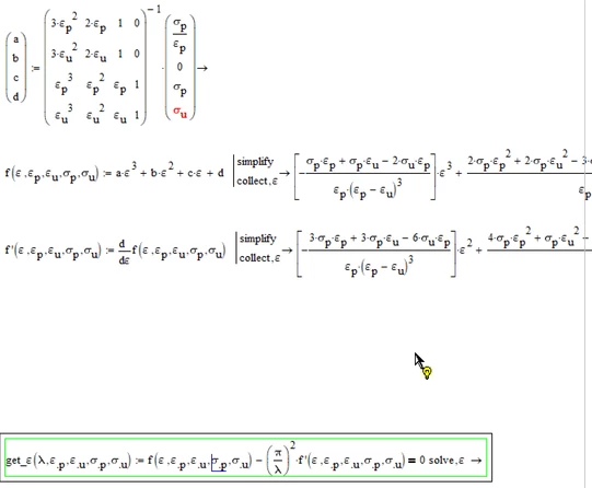

I want to solve for X a cubic equation that contains a vector as an input
I am trying to solve a cubic equation for the unknown X, but one of the input parameters is a vector. I tried to solve symbolically and then substitute the vector but something doesn't seem right. Then i tried to program a function that solves it for every value of the vector input, but since the result contains 3 solutions, it doesn't work.
I hope you will be able to find a solution.
Thank you in advance.
P.S. The file is uploaded

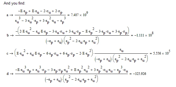

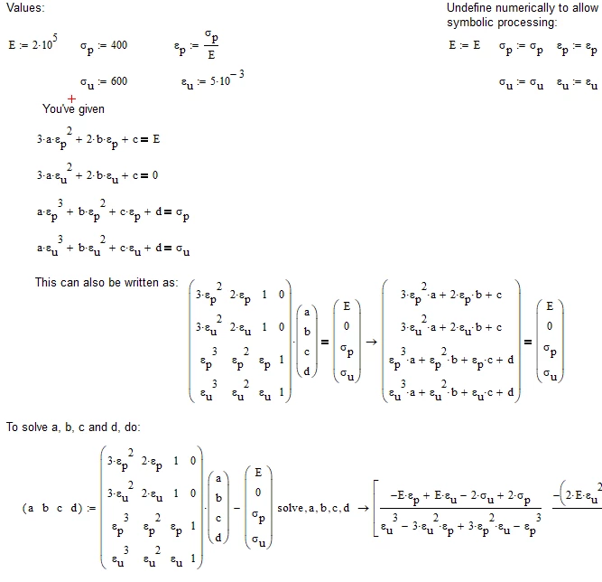

February 11, 2018
Is this what you are after?
(The symbolic result stretches out further to the right)
I prefer a symbolic solution in general, because it can provide more insight...

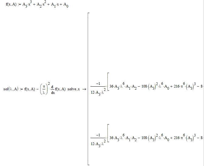

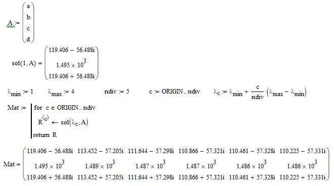

February 11, 2018
Yes, it couldn't have been as simple as that.
I've looked a little further and came to this (continuing from the previous):
Again, this solution runs far into the right. It's the general solution for a third-order polynome.It gives 3 values for each lambda..
With the result I can continue:
This solution (e.g. for lambda=1) is different from what you find. Where do I go wrong?
