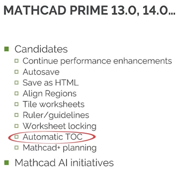

 Frankly, Mathcad is being left behind by competitors. From the candidate feature list for Mathcad Prime 13, Maple Flow already has autosave, align regions and automatic toc (with hyperlinks). Units entry isn't as smooth, but they tell me they're working on Mathcad like entry of units
Oh, Prime is not only left behind by its competitors but also by 20+ years old legacy Mathcad. We had no automatic TOC (we had the ability to create nice hyperlinked ebooks, though) but we sure had autosave and region alignment.

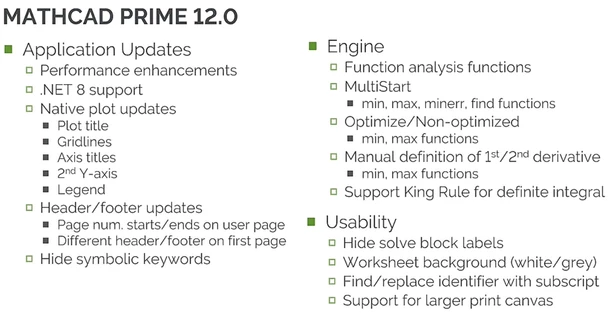

In return, the next version will offer the option to change the background color—oh no, not freely from a palette, we will only have the choice between white and gray. Wow!
We will have to wait to see how the promised improvements on the native 2D plots are actually implemented. From the announcement it looks like we are at least approaching old Mathcad now in this respect with version 12 of Prime. I guess the formatting abilities of the 2D plots still will not live up to the ones we had back in the good old days, though. We had much better control over the look, more different line widths and could set the size of the line and the dot/symbol independent from each other.

Another nice addition to the user interface would be the ability to trace dependents and precedence.  In Mathcad 15 I was able to cut and paste variables into the find feature then find where they were used.  Perhaps I just don't know how to use this feature properly in Mathcad prime but when I cut and paste the variables, the variable with subscripts... doesn't display properly in the find and so it can't find where the variable is used automatically.

"but when I cut and paste the variables, the variable with subscripts... doesn't display properly in the find and so it can't find"
(Just some of) your prayers are being heard. See the overview of features planned for Prime 12, in Werner's post of 2026-01-23 04:45 PM above here.
But I'll fully agree that it should not have taken PTC a full 12 iterations to implement this feature properly when (real) Mathcad, Prime's predecessor, had this already properly functioning in the past century.
