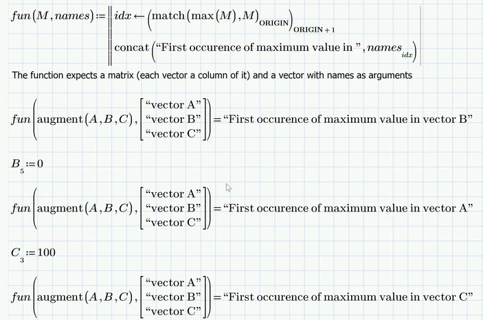

Werner_EAnswer
Jul 10, 2024 9:16 AM UTC
You may also omit the "augment" function in "max" when using Luc's solution.
Depending on which way you need the result, you may turn it into a function.
Unfortunately there is no way we could automatically access the name of a variable.
Prime 10 sheet attached

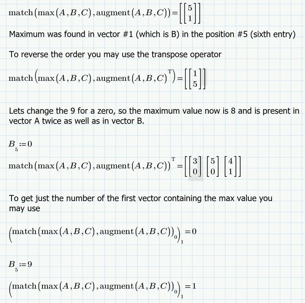

Use
match( max( augment( A, B, C)), augment( A, B, C))
And inspect the vector of results.
Update:
See attachment
Jul 10, 2024 7:10 AM UTC
I was curious and tried Luc's solution.
Werner_E25-Diamond IAnswer
