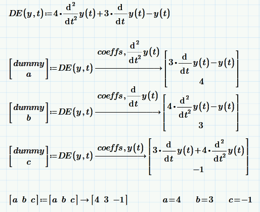

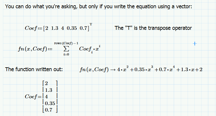

So what i'm looking for is a way to have mathcad prime look at an equation and store coefficients as variables - maybe by comparing the equation to a "mask". please take a look at the attached file to see what i'm talking about.

If you input the equation in the right way, you can have the coefficients as a vector:
So this can be made to work with polynomials.  How would you get an equation without typing it in?

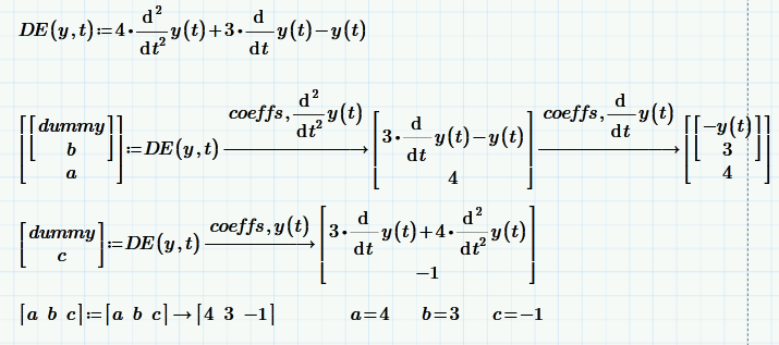

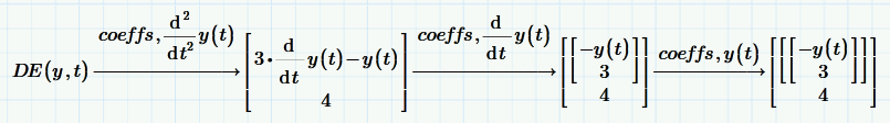

You can do this (in Mathcad 11, something similar should work in Prime:
But this fails in Mathcad 11, because the coeffs symbolic instruction expects the expression to be a polynomial that is expressed in th argument of coeffs:
Maybe by combining the results it could be made to work...

Pretty cumbersome:

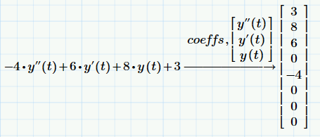

Then there's this:

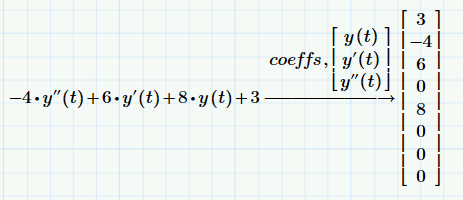

or, reversing orders:

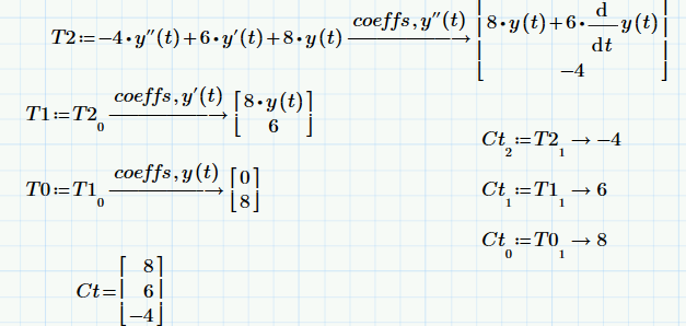

I also can't think of anything else than what Luc already had shown:
[EDIT: In the meantime Fred had proved that its possible to do using a cool two step method.]
I guess it could be possible to tun those calculations into a program in Versions of Mathcad from 15 down but this sure is not possible to do in Prime as it does not allow symbolic calculations inside of a program.
Cascading also shows limitations:
but we could at least do something like

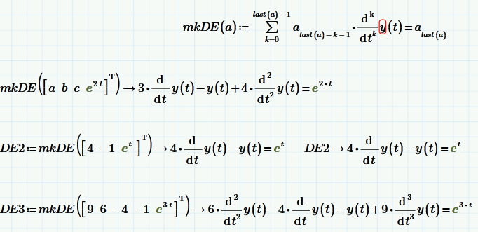

BTW, here's some kind of the reverse direction:
