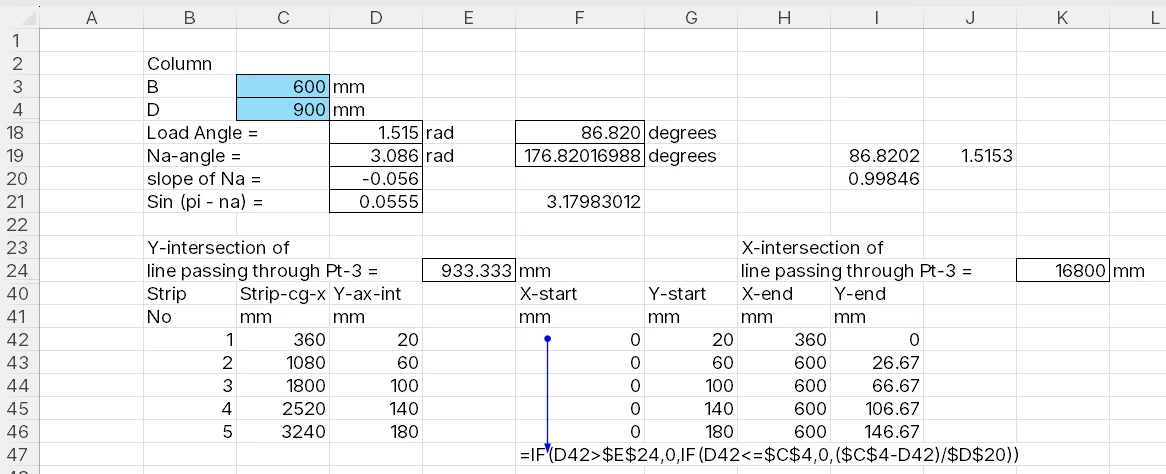

I have created an Excel document in which I calculated the start and end coordinates for strips. The total number of strips is 23. I generated the strip data using table options in Mathcad.
Now, I want to perform the same calculation for strip start and end coordinates directly in Mathcad. Please refer to the calculation used in cell F42 in Excel. How can I replicate this equation in Mathcad?

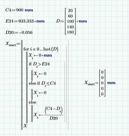

Here’s a close translation into Mathcad Prime (using version 12).  (There are alternative ways).
Alan.
Jun 15, 2026 12:46 PM UTC
Alan.

Thank you very much
